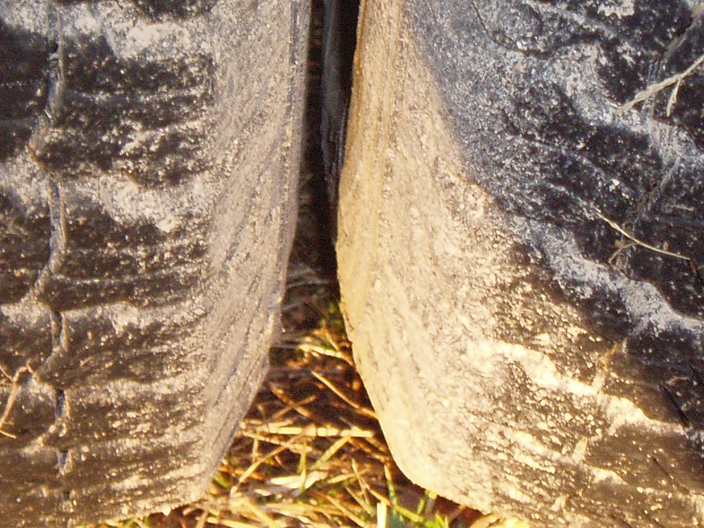

I had 4 285's and tried 2 of them before i bought 2 more. In the air they did not touch. Once I put the truck down they just barely touched. With 1/4" spacers i have a 1/4" gap.

Here they are. The tires are Goodyear Silent Armor Pro Grade 'D' Load range. LT 285/70/R17. Max cap on Psi is 65, inflated to only 52psi. I have a 1/4" spacer between them currently (giving me about a 1/4" between the tires with just the weight of the truck), with plans to find (or have made) longer studs in order to fit a 1/2" spacer to allow for more load.
I loaded the truck about 1200 to 1500 lbs today and they were just about touching (probably did on bumps in the road). Probably because i only have them filled to 52 psi, but 60 was just to hard of a ride. I know i will be at ease with the 1/2" spacers over the 1/4".
