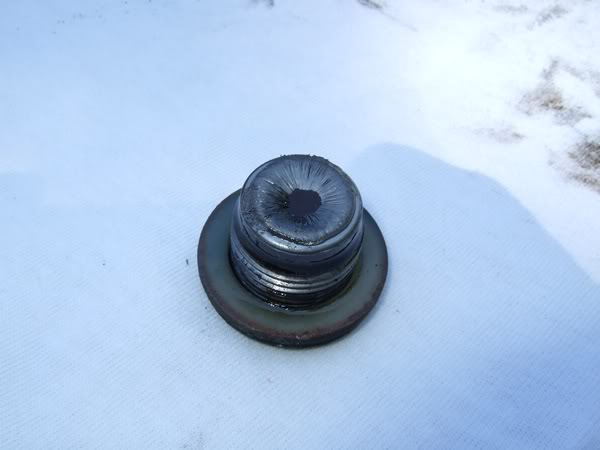

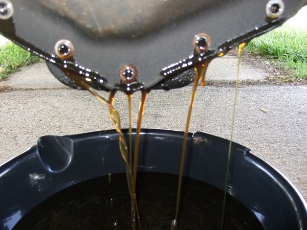

Finally got around to changing my rear diff fluid today. The fluid used was the regular Amsoil Synthetic 75W-90 and it has been in the diff for five years and has over 100,000 miles on it. I was wrong earlier in this post on what my mileage was after I thought about it. It was spring 06 when I changed the fluid last. I will get to the front one of these days. I'm not worried about the front since I have the Dynatrac kit installed and has about 50,000 less miles on the fluid. Amsoil Synthetic 75W-90 went back in.
