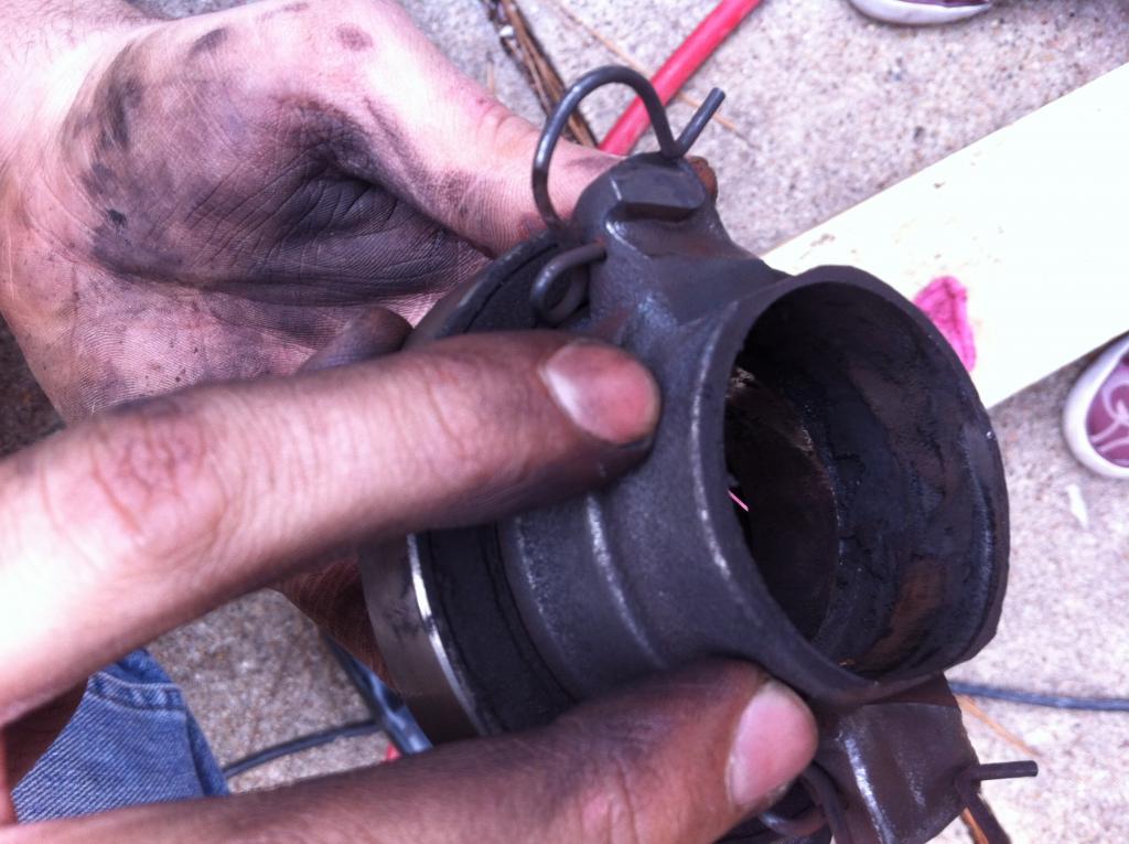

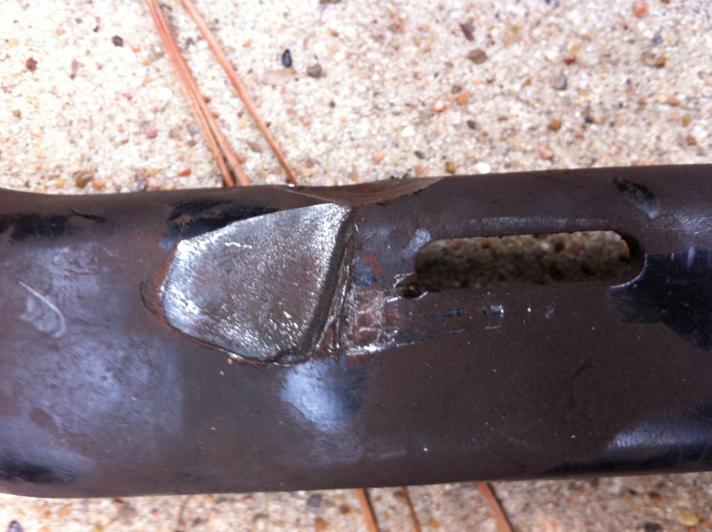

ok so i dropped the tranny this weekend and these are what i found the throwout was still free spinning but was on its way out and for some reason some how it shifted on the fork which grooved it valair is sending me another one for a small fee of course i should have it in this weekend i cant understand how it shiffed if the throwout goes around the input shaft any ideas???????

Are all the other parts lining up and seating like they should? Look over everything really good while you have it down. Lay the parts on top of each other like it assembles and move them around to see if you can find something that's out of whack before you put it back in. Sometimes just "studying and staring" at things will unlock the puzzle.
