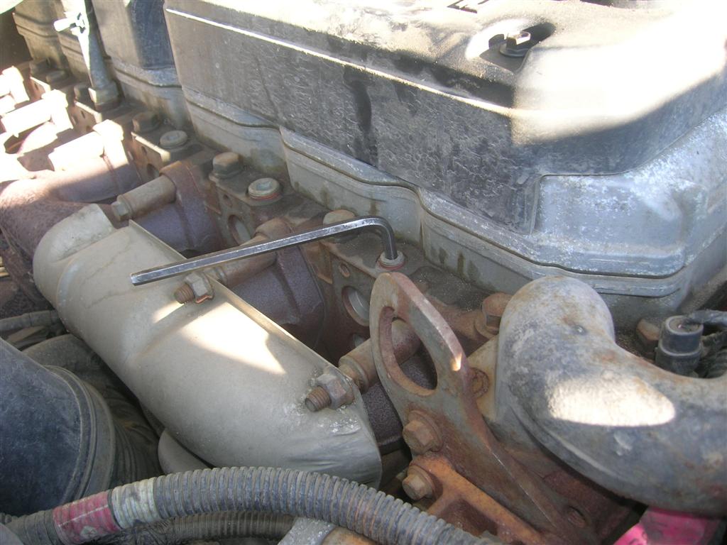

Instead of cutting in to the heater hose I simply pulled one of the bungs on the block to purge air.
Attached a pic with an allen key inserted.
This way you are guaranteed of getting the air out of the block before you even turn the key. I hadn't heard anyone mention it so up goes the pic...
Edited to add:
One more thing... cold water + hot engine block = bad Either wait for the block to cool or boil your distilled water and pour in hot.
Since I chose not to use distilled water I just took my hot water out of my hot water tank.

If you fill slowly you shouldn't need to remove a plug, but a removed plug allows for faster filling.
Why are you changing coolant on a hot block? Just let the block cool and use distilled water, its much better for your cooling system and block.

An easier alternative would be to remove the heater hose coming off of the pipe that goes into the the top left of the block towards the back of the engine. This point is higher than the location of the plug, and it only requires plyers to remove.
I used this method for removing the air after the flush. I think that it is the easiest and like 1st gen said it is higher than the bung thus all the air is out.

I still don't see why everyone is worried about air escaping. The thermostat is designed to let air out. All you have to do is fill it slowly. You can't pour fast enough to have issues.
