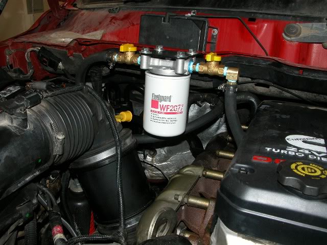

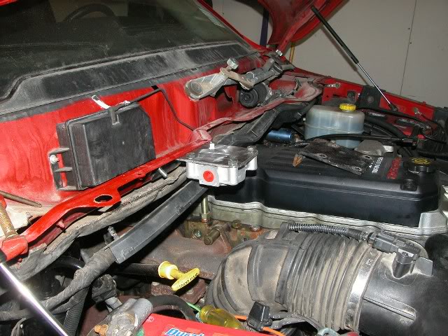

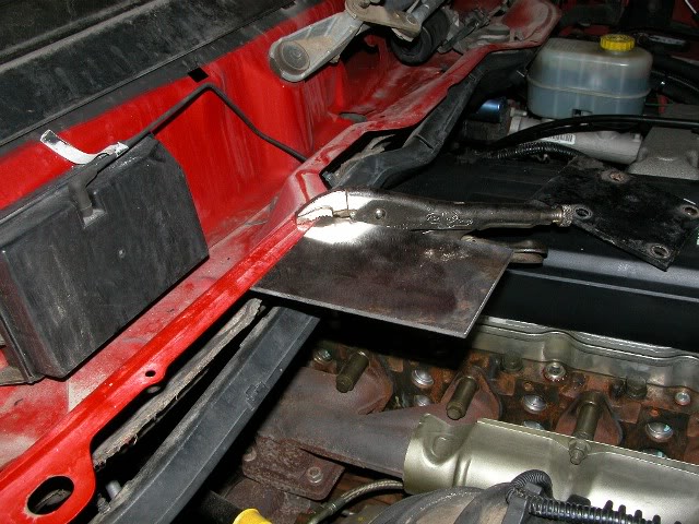

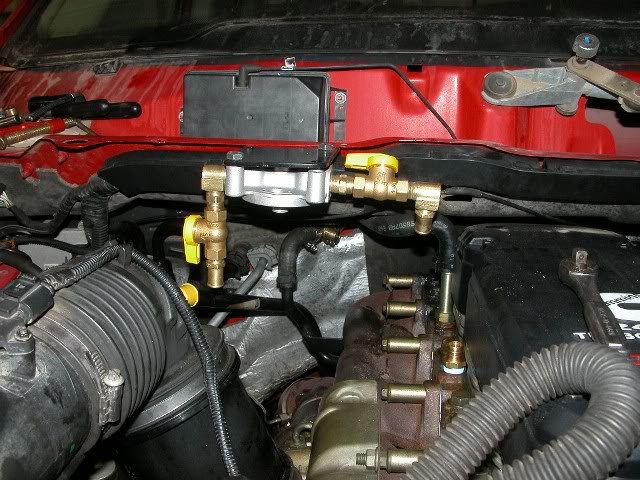

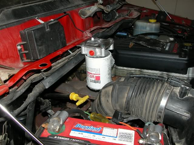

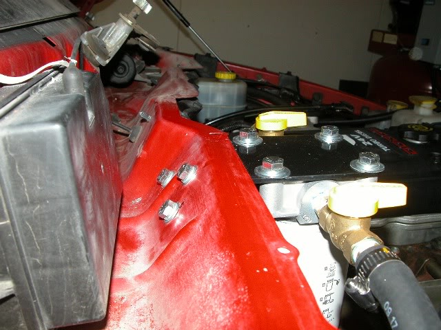

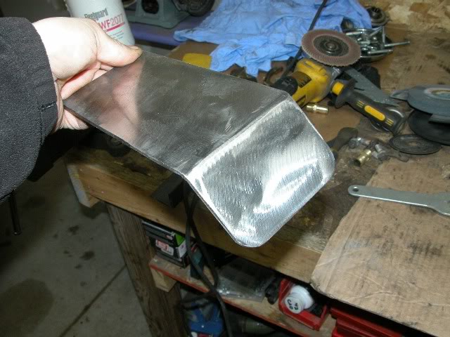

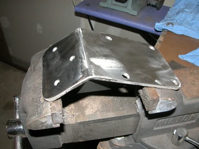

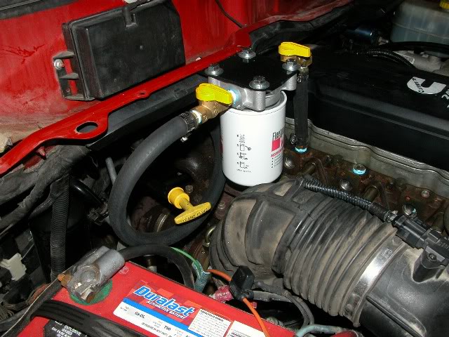

This is how I did it and me m using this antifreeze http://www.valvoline.com/products/br.../antifreeze/43
Good for 7000 hours 300000 miles
Total cost was 100 $ with new antifreeze and thermostat

Old Apr 26, 2011 | 08:57 AM
  #71
bigblue1ton's Avatar
Posts: 78
From: Spring Lake NC
^^ with the filter mounted that high would the two shutoff valves still be necessary?
Old Apr 26, 2011 | 10:03 AM
  #72
AH64ID's Avatar
Posts: 4,737
From: Kuna, Idaho
Originally Posted by cminzey
AH didn't you use 3/8 out of the head to the base and then 5/8 for your return to the heater hose
I ran 3/8" to and from the head, and it dumps into the 5/8" heater core return.
I don't get putting a filter, of any kind, over the exhaust manifold... But then again I am trying to do everything I can to keep the engine bay cool. Otherwise it looks great! Hopefully you flushed the fool out of your motor I hear HOAT doesn't play well with others.
I didn't use shutoff valves where mine is located. When I changed the filter I lost maybe 1/2 cup of fluid is all. For me, the valves would have been a waste of money.
Totally agree, awesome job on the install. I'm also not a fan of anything over the manifold. Not for fire reasons, but heat reasons when slow going.

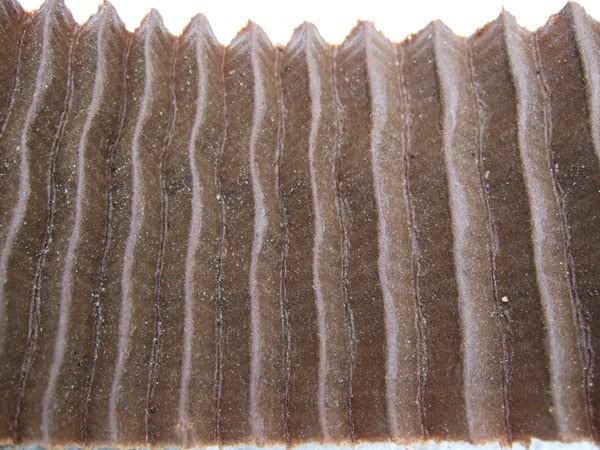

Here is what my filter looked like on the inside with 17,600 miles on it.
