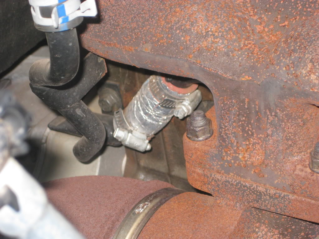

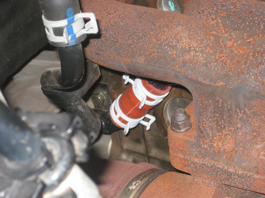

I don't have a pic, but the other trouble spot is the hose that goes to the overflow tank. Where it connects to the filler neck of the rad the factory doesn't bother to put a clamp on. Several people including me have had it leak there. Get a small hose clamp, I like the spring type, but any will do. Since you said you are seeing coolant near the filler cap, that is most likely the culprit. I also had the hose in the picture above leak, it only does it in the fall when temps cool off. I replaced mine with an upgraded piece from the factory. Pics below. BTW, your dealer doesn't sound like they have much on the ball.

It goes in place of the hose shown in the post above mine.
Old
New
