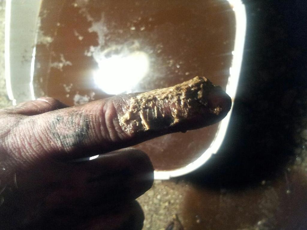

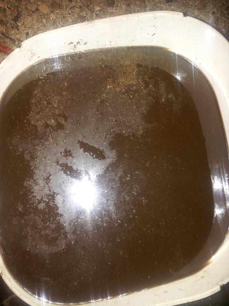

*********** So.I check the oil in every way no milkshake no cooliant in oil.So I didnt have access to a hose but I pulled bottom hose&poured about 20 gallons through.Now I know that's not really cleaning it out but till tomorrow or tues is has to do.Now when I pulled the bottom hose I caught this junk in the picture it is I belive oil as it rose to the top & I skimmed it off for the pix.

Nasty looking coolant. You possibly have a blown head gasket. You can get oil in the coolant, or coolant in the oil, or even both depending on how/where the head gasket broke. I've seen a slight sheen in my coolant when I changed it last time.
For the overheating, do you still have the oil breather bottle (puke bottle) mounted on the front of the engine? If you do, your radiator is likely clogged. The vapors from the bottle collect on the radiator fins, which then collect dirt/dust. Won't be visible from the back (fan) side of the raditor, the front side gets blocked off.
