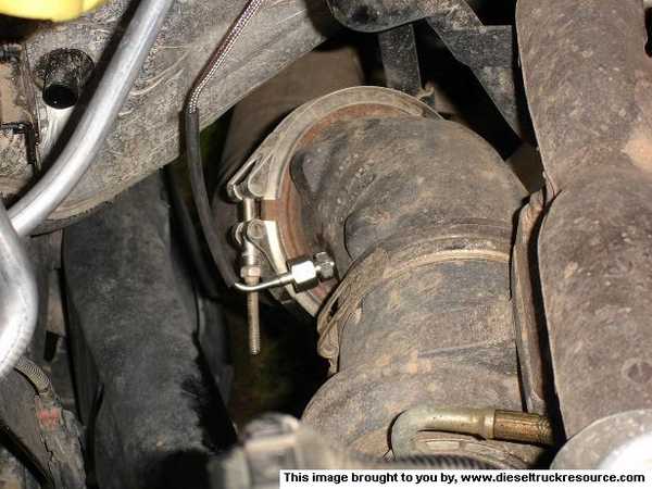

mine never runs that cool, I'd say mine is more like 490*or so, my mount is post turbo.
[/IMG]
Old Feb 24, 2007 | 10:38 PM
preloader's Avatar
Posts: 235
From: Dallas,TX
