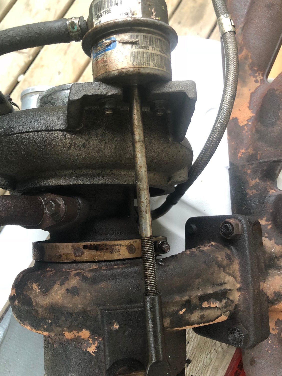

Modified wastegate?
I had a chance to look at the 2003 turbo wastegate. It has a threaded adjustable actuator rod. Is this stock? Maybe it has been modified?
Chay
Old Mar 27, 2019 | 04:06 PM
  #35
StealthDiesel's Avatar
Posts: 1,245
Likes: 17
Going by those pictures, that does look like the stock Dodge Cummins 2003 HE341 turbo wastegate.
Both the 2003-04 HE341 Cummins turbo and the 2004.5-07 Cummins HE351 turbo wastegates are adjustable but the ECM is monitoring boost levels with the MAP sensor.
If you bump up the boost too much, the ECM will set Overboost DTC's.

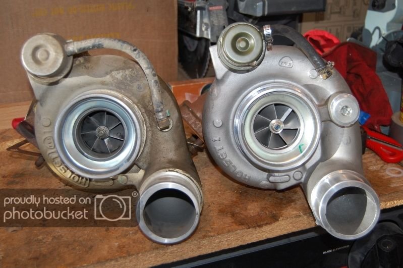

Just for reference, here is an old pic from my photobucket account. The pic shows a HE341 turbo on the left and a modded HE351 on the right. This is from over 10 years ago.
If I recall, the HE341 specs are 56mm/56mm/9cm. HE351 specs are 60/60/9.
Technology has long passed these old turbos though. My twin turbo's are now ancient too. Modern turbo's are way superior to these old Cummins turbo's.

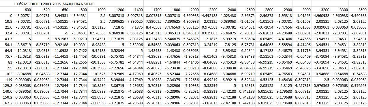

Here are the tables I calculated and loaded with HP Tuners:
This is the stock 2003 timing map:
This is the table, modified for 2004.5+ values (100%):
And here is a comparison, to show how much the vales have changed:
Here is the half way between table (50%) I'm currently running:
And a comparison to the 2003 for the 50% table:
Note that this is just the transient table, but the low density table is very similar, and I used identical techniques on the math.
