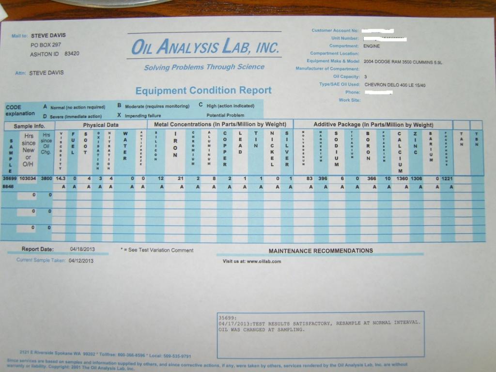

Got my oil analysis back today. This is pre-bypass filter. Next 5000 I'll send another one in and see what changed!
Attached Thumbnails Amsoil by-pass filter install on 05 3500-dodge-oil-analysis.jpg
