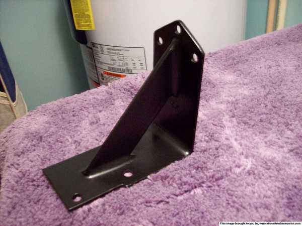

Old Mar 23, 2008 | 07:35 PM
rjm022's Avatar
Joined: Mar 2004
Posts: 1,803
From: wilson,ny
https://www.dieseltruckresource.com/...9&d=1167438120

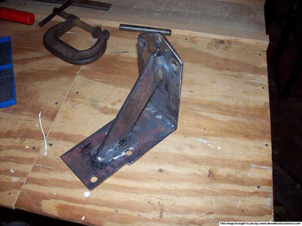

Old Mar 24, 2008 | 02:53 PM
Shagginwagon's Avatar
Posts: 419
From: West Linn, Oregon
Originally Posted by mmurray
New Question: does a bypass filter actually clean better or does it just give better access to the filter for changing?
Cleans better. The bypass filters down to 2 microns, whereas the stock full flow filter only filters to around 30 microns. The bypass systems leave the stock filter in place to catch the big particles. Here's a few pic's of where I mounted mine.
Got any better pics of bracket? You order extra hose with yours? Nice setup.

Mine's mounted the same way as *******'s. You'll have to make the bracket it's about 6" out and 6" up.
Old Mar 24, 2008 | 10:55 PM
purduepurdy's Avatar
Posts: 385
nice, wish i could weld, think jb weld would work?
