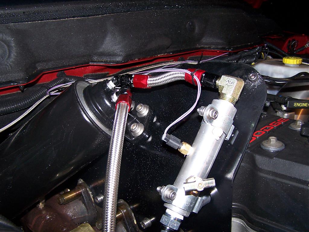

here is how i mounted mine. i did have it mounted on the driver side of the engine. i just sent off my oil sample so i shoud have results by early this week. i have been using Royal Purple with that big bypass filter. this will be my first 3000 miles on that oil with the setup. cant wait to see how it is doing. if anyone would like my old bracket, let me know. we can work out a deal.... he he h
Driver side? Isn't that the exhaust manifold below it?? Also whats the contraption the pet **** is in?

From: Kirtland AFB Albuquerque
it is above the exhaust manifold but gets no heat soak at all. i tested that with my infrared temp reader. as far as that contraption. its a 1 1/4 aluminum bar that i had drilled, and tapped so i could have multiple ports with plenty of oil flow. i love it because is alows the oil temp sender to be right in the oil flow not out of it. i made it because i hate brass T fittings.
...its a 1 1/4 aluminum bar that i had drilled, and tapped so i could have multiple ports with plenty of oil flow...i made it because i hate brass T fittings.
FYI...http://www.a1manifolds.com/default.aspx has manifolds cheaper than they can be made, even at home!

well i only needed 3 ports, not 15! :-) the local machine guys made that one for about 15 bucks. guess they like me.
