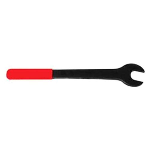

I use a fan wrench 36 mm turns the engine over easy, just mark the TDC with some paint. Done it that way for years. Will not work on 2013 and up since the fan was changed to larger size
