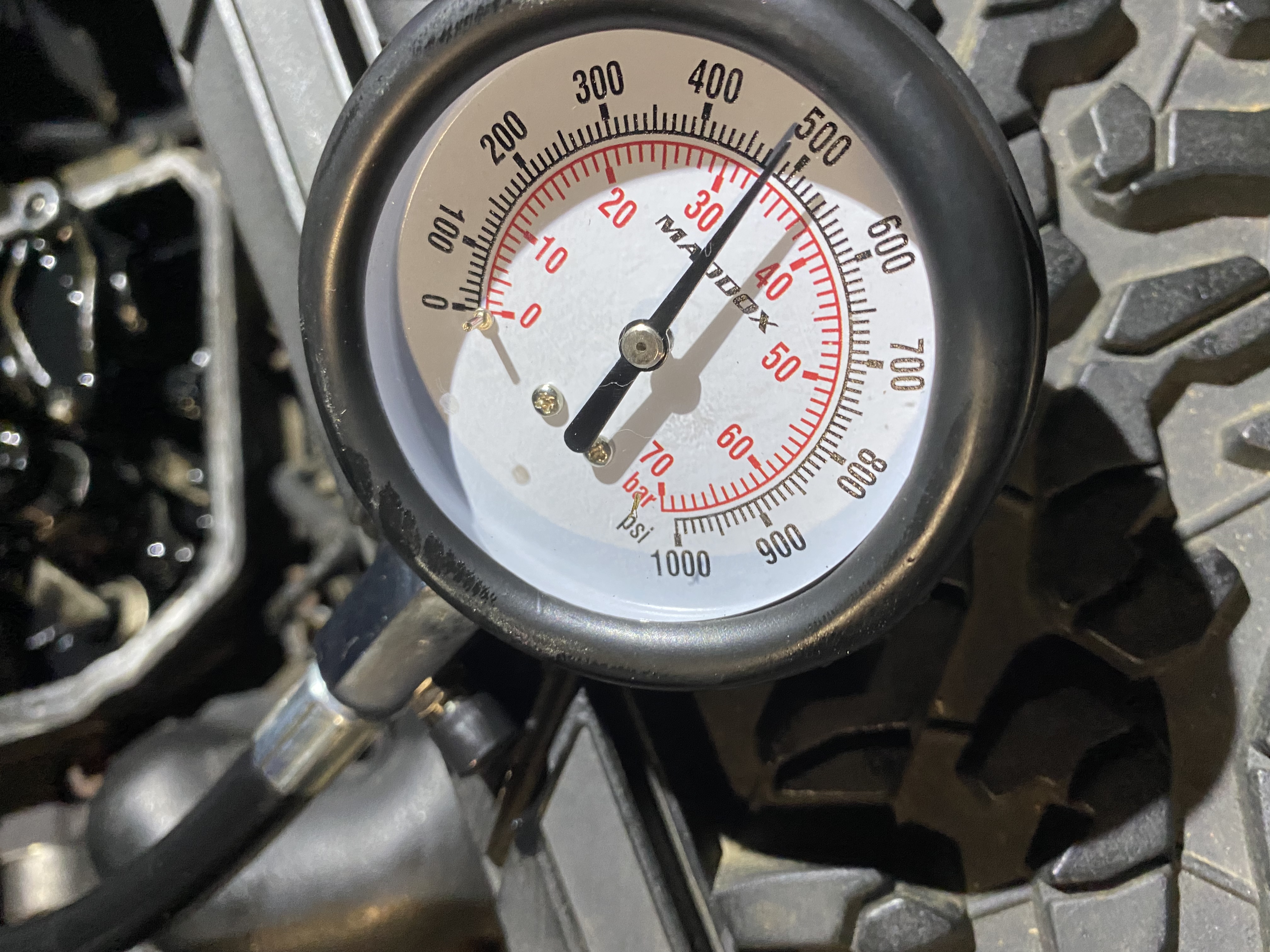

Bought the truck private party about 2 months ago it’s a 2006 dodge 2500 5.9 Cummins 24 valve common rail. Has 216k miles on it now, I replaced the turbo with an exact oem replacement holset turbo and new exhaust manifold. Truck ran great for a month and drove it to work and back one day but I whent to the store after work one day and it started missfiring and throwing some light white smoke, instantly turned around and stopped, ran #3 injector codes, ended up swapping #1 and #3 injectors due to a electrical lead breaking on the no 1 injector cylenoid. Also put a new electrical valve cover gasket on. But it still is misfiring and rough idle with white smoke to reiterate There hasn’t been any white smoke for a month of daily driving with the new turbo only just recently it started and the white smoke started instantly it didn’t progressively get worse. It came all at once with the rough idle and miss. I don’t know how to set valves but I’m fairly certain the rings are fine because I have no blowby and my compression test came out to 500psi on the #3
im looking for suggestions on what to look at next I don’t have a shop only a the basics and a few special tools. I’m going to swap out my FCA this week but I doubt that’s the main issue because I only have a miss on the #3
it does not get better will hot or driving

I would;
  1. recheck the wiring going through the valve cover to insure it wasn't damaged during installation.
  2. Clear codes and start engine.
  3. If the misfire is still there, I would recheck the torque on the high pressure connector retainer nut.
  4. Clear codes and start engine.
  5. If the misfire is still there, I would pull #3 and #4 injectors.
    1. When pulling the injectors, compare the two as you pull them out.
  6. Reinstall, but swap injectors to see if the P0303 returns for the cylinder or P0304 comes up following the injector. Use new washers (shims).
  7. Clear codes and start engine.
  8. If P0304 shows up, you probably have a bad injector. If P0303 shows up, it may be your harness.
I don't have a shop either, not a mechanic by trade, worked on my '03 when needed. I had my injectors rebuilt by F1, now called FDI. I was very happy with them. Be careful with torque settings.

Issue resolved unusual culprit
Originally Posted by Billy 5.9
It’s a long story but I’m just gonna give u the whole rundown
I gave in and took it to a reputable Engine shop around town and the tech there found my #3 cylender had a broken exhaust rocker and stuck the valve open or it was not sealing all the way, he replaced it and boom no more misfire and runs good as new, also a good idea to check your valve rocker spacing next time your under the valve cover. Intake is .10 and exhaust should be .20 if I remember correctly. Happy troubleshooting gents back to morning brew
