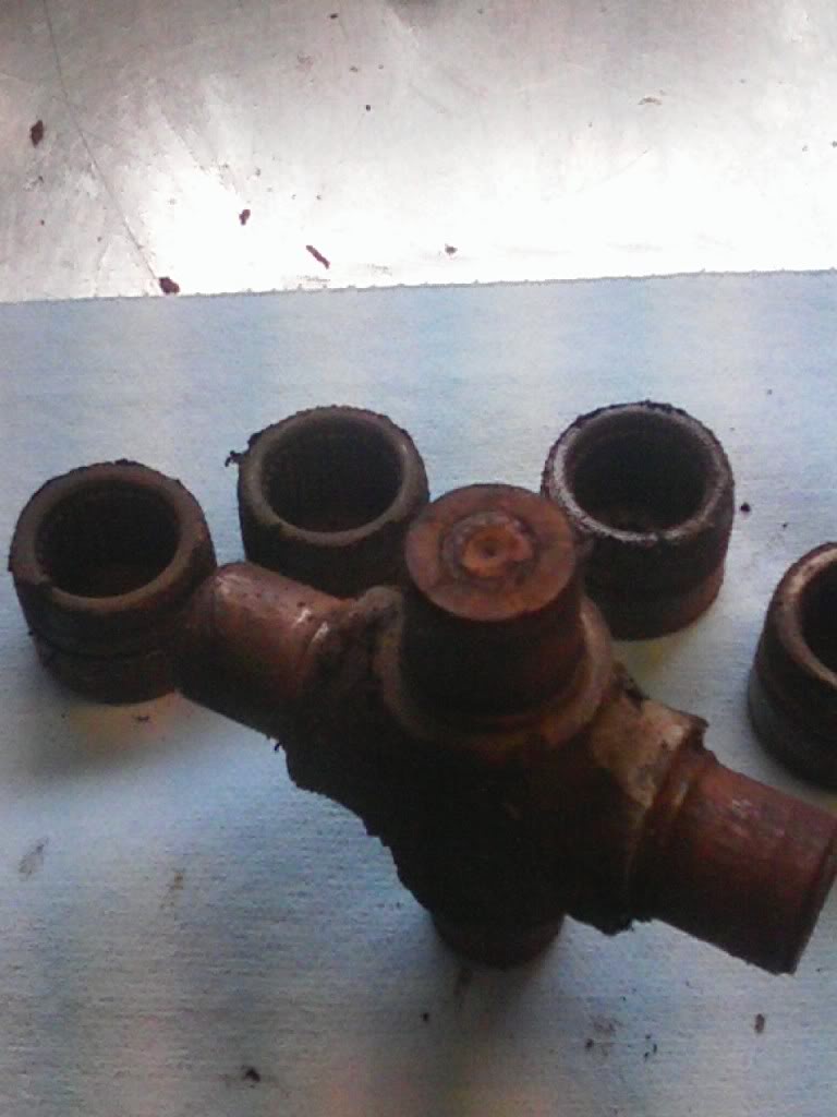

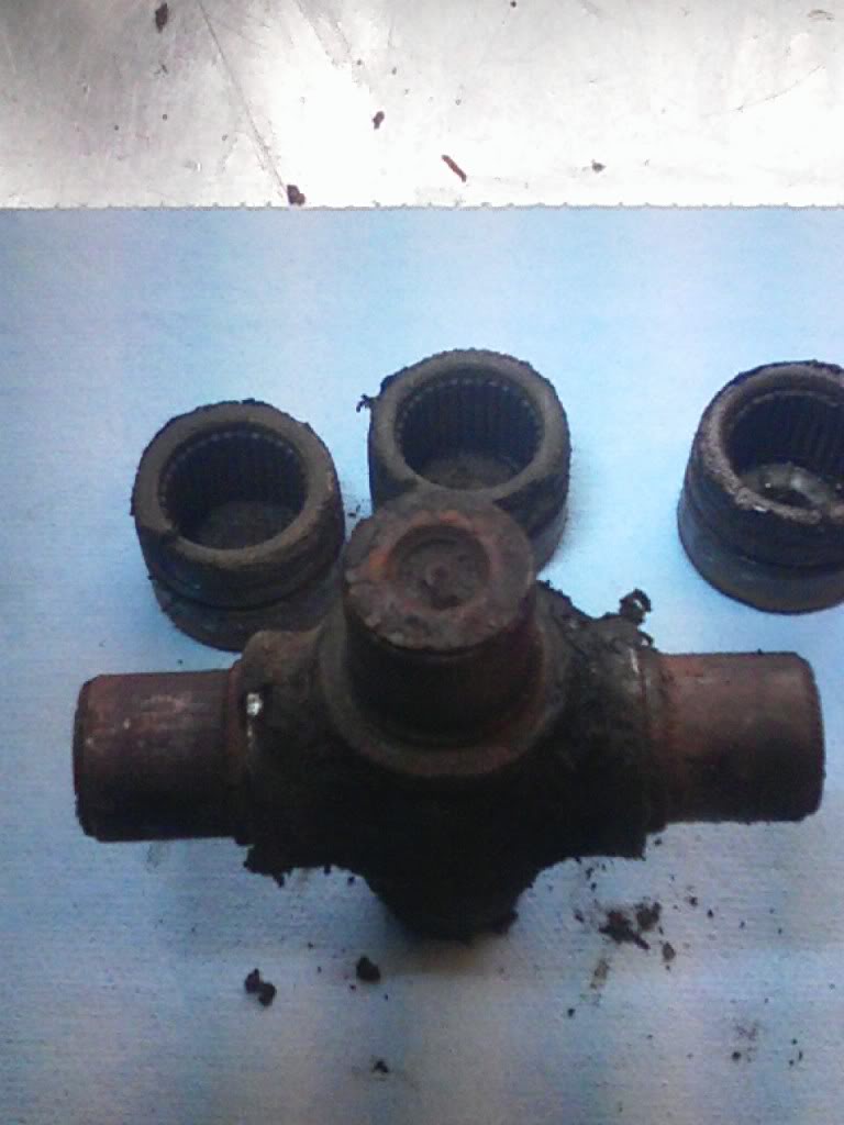

here is a pic of a joint out of my truck that was lubed every month (approx 3000miles per month). even if you grease it there is no garrentee that the grease makes it to the cup, heres the reason why
only one yoke would take grease, all the others were plugged up
