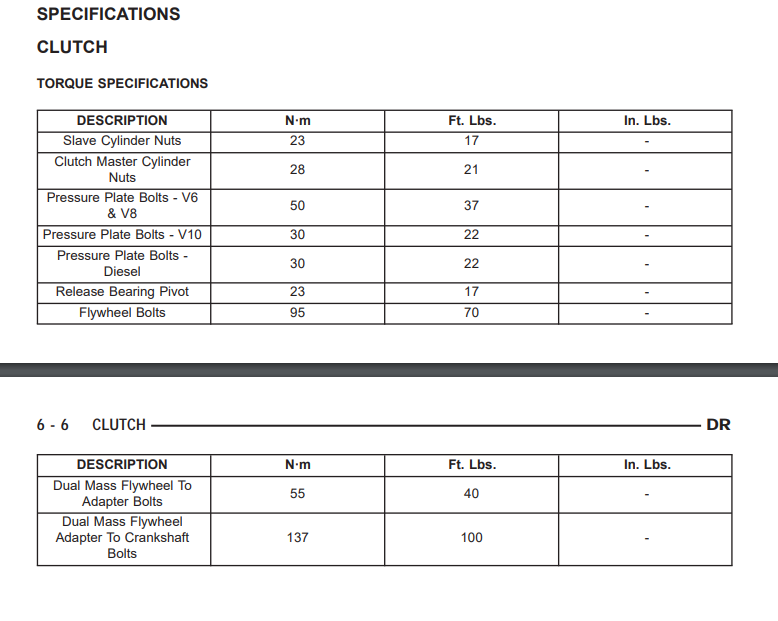

Old Dec 6, 2023 | 04:17 PM
mgalvez's Avatar
Joined: Sep 2023
Posts: 6
These are the torque specs that are in the manual. That is the extent of information that I could find.
