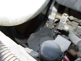

No the pump will come off without removing all the other BS. The first pump broke the shaft and FUBAR'ed the pulley, ran over the shaft and impaled in my tire :>( On the second pump, the pump went out and if I remember correctly, I used the old pulley. Now this is on a 2004 model.
Here is a picture of the pump...as you can see there is nothing in the way. I didn't even have to take the radiator hose off either. There are 2 hoses and two Torx screws that have to come off, and the pump can be lifted out. Be prepared to make a mess as the fluid will get on everything. I drained as much as I could into a drip pan (shallow 2' X 4'). A old blanket will suffice.
