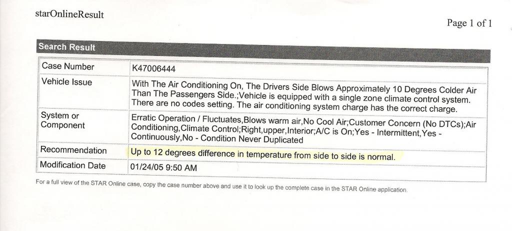

2004 Dodge 2500 Diesel (bought new), for the second time Monday I had to replace my power steering pump. Both times the shaft came out. First time was 37,000 miles (you bet ya...right after the warranty ran out) and now 69,700 miles. On the first failure the shaft came out completely, broke the drive belt and I ran over the shaft and pulley with my right rear tire...yup nice hole. This time I got lucky and shaft was out but not completely, but another shredded drive belt. This being the second time, I called a Dodge dealership, to inquire about this problem. Would you believe they had the gall to tell me that they have never seen this happen. Yea, just like the time they blew smoke up my azz, telling me that the temperature differential with A/C between the drivers side and passenger side will vary 10 to 14 degrees.

1. Fan clutch out at less then 36,000 miles..covered under warranty.
2. Fuel gauge inop. told them it was the gauge, but they wanted to replace the pump, no fix, then they wanted to install a out of the tank fuel pump..no fix..Changed the fuel gauge..fixed. Covered under warranty.
3. Defective
front tire..goes bump..bump..bump belt broken. Dealer says I have to go to Michelin for warranty, not covered under car warranty. Tire dealer says nothing is wrong, can't SEE any defect. Lost all my business..I now run Hancook 10 ply. Great service.
4. Right front door rubbed against the weather strip, now it's trash. Since I hardly ever ride as a passenger, didn't notice it.
5. Two power steering pumps as stated above.
6. Brought vehicle to dealer no less then 5 times for the A/C. Told them it was the mixer, they refused to dig into it, claiming..see attachment.
