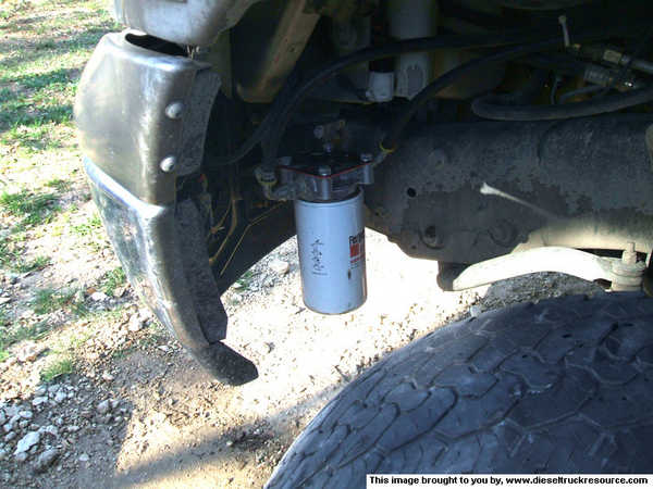

This is where I mounted mine. Purchased the kit that mounts on the air horn but relocated it here since I have the engine mounted TPS. I welded a piece of metal with holes in it to the fender support bracket. The filter is bolted to the metal piece.
Had to purchase a few more feet of fuel line. The fender liner goes back on no problem.

Looks to me, that might not be a good location. A rock thrown by the tire can puncture the filter and cause it to leak.
You could make a shield to protect it on two sides.
I re-read your post and forgot about the fender liner.

I don't like the spot in the picture above, looks like it's tire time too Al.
