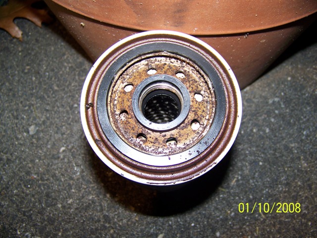

I will try and get a picture of the rusty filter. I am meticulous about the maintenance on my truck and can tell you everytime I greased a fitting, lubed the door hinges or rotated the tires. That 23k miles is just over a year in service so no the truck dosent sit.
I never got a drop of water out of the stock canister nor ever had the water in fuel light illuminate. That is why I am confused why this happened.

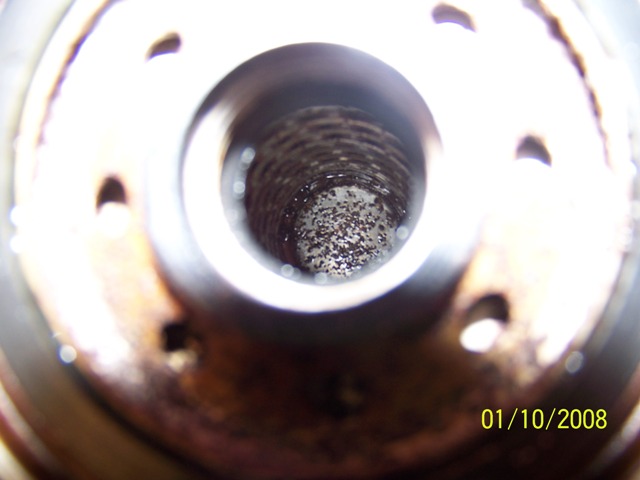

How's this.
Attached Thumbnails 2 mic fuel filter rust-100_2460.jpg   2 mic fuel filter rust-100_2462.jpg

Wow!!!........

Yep WOW lots of moisture.You may never get the WIF to illuminate as it seems none do.Diesel fuel has moisture in it.I don't care if I ever see a drop of water in my truck I drain my fuel filter cannister some on ever fill up if possable.

WOW Thats a nasty filter! I wonder just how effective the water separator is in these trucks. I've actually thought of adding one of Glaciers filter heads and the Fleetguard fuel water separator just after my pump and run it along with the stock canister. Would the Walbro pump be effective running through the aftermarket F/W separator then through the stock filter and F/W separator then through the 2u filter?
How exactly does a water separator work anyway? Does it just provide a pool for the water to settle into or is there some other magic going on that I'm missing??

And back to the filter/pump thing.. . My Walbro pumps fine thru 4 filters, 2 of which are 2micron or better. Not a problem at all....

Did you use a rubber o-ring or gasket on the center post with the CAT filter. I'm not talking about the large one towards the outside of the filter diameter. I think my small rubber gasket came off with the old filter and I never put it back when I installed the new one. I have no leaks and didnt notice until I was looking at the picture of my filter.

Look at the picture on page 2 of this thread at the CAT filter.... there is no inner O-ring.
