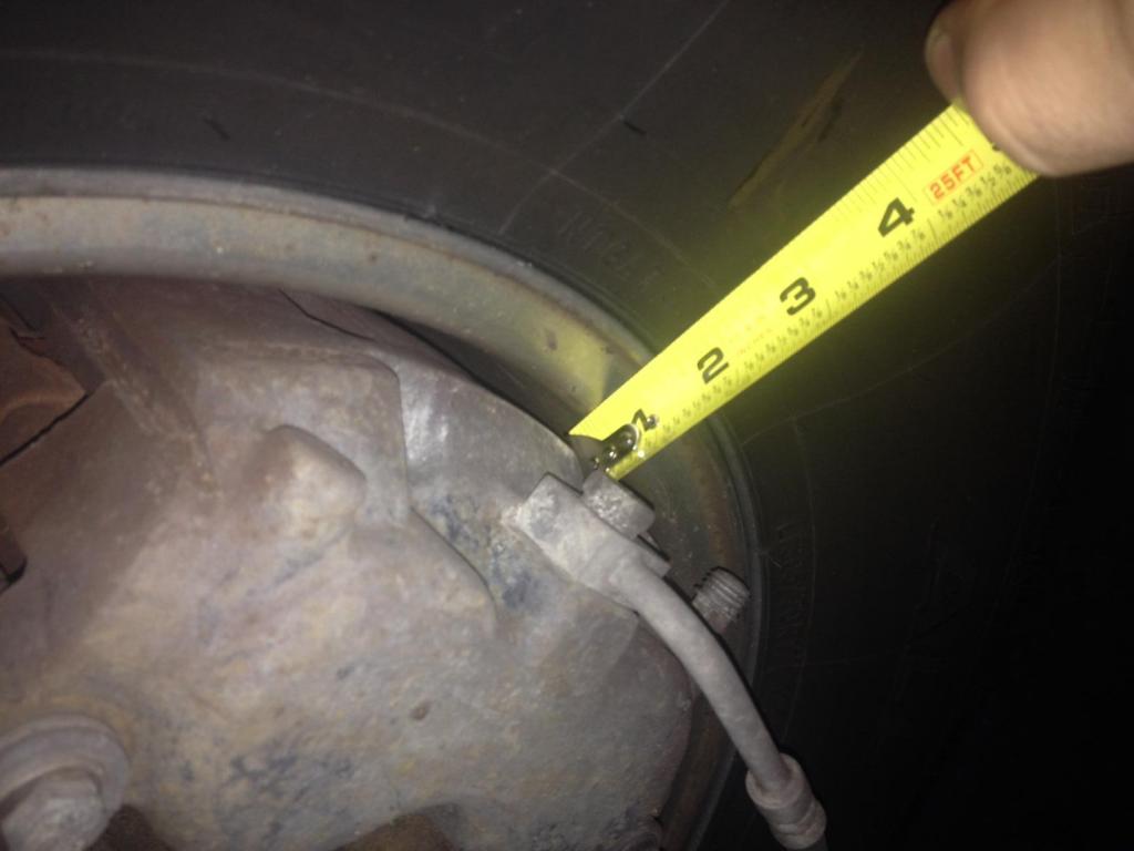

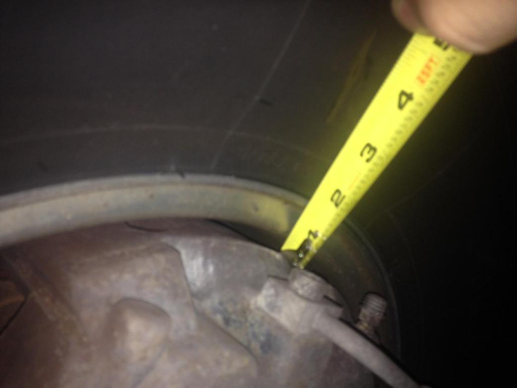

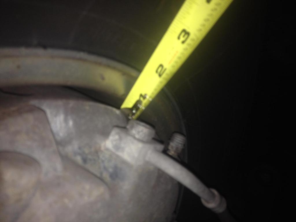

The pics are bad, but I measure 1/4 inch at the closest point from my 17s...
Just my opinion... I'd have a hard time shaving anything off the calipers or rims. I'm just thinking about a failure of my brakes on a 7k pound truck... what's it worth?

The pics aren't worth a dang... my bad. Sorry, it's dark and I've had a few beers. At least you know I got under the truck for ya
