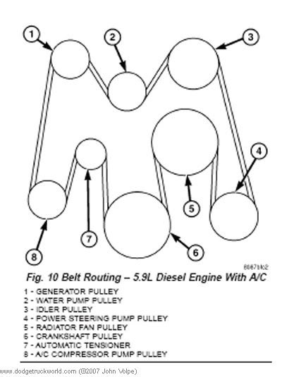

Here is a diagram of the belt routing. It's a good idea to replace the idler pulley and tensioner while you are at it. Hope this helps.

hi thanks looks like i might have too remove the fan shroud to get to the tensioner off any more info you might have would be great
