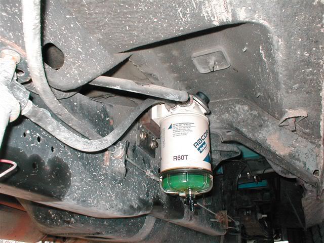

i think he needs a filter setup like this, it's a 2 micron racor(edit) 10 micron

when I goolge this filter (checking price & where to buy). It comes up as a 10 micron filter

johnh thats not a 2 mic racor the r60s is 2 mic, r60t is 10 mic.......all racor brown colored filters are 2 mic. blue is 10mic and red is 30mic
Old Aug 12, 2010 | 04:29 PM
johnh's Avatar
Joined: Nov 2002
Posts: 4,053
Likes: 29
From: lyman, utah
you are correct, the filter i have been using is a r90s.....i initially had the 60t because it came with the kit i bought.
