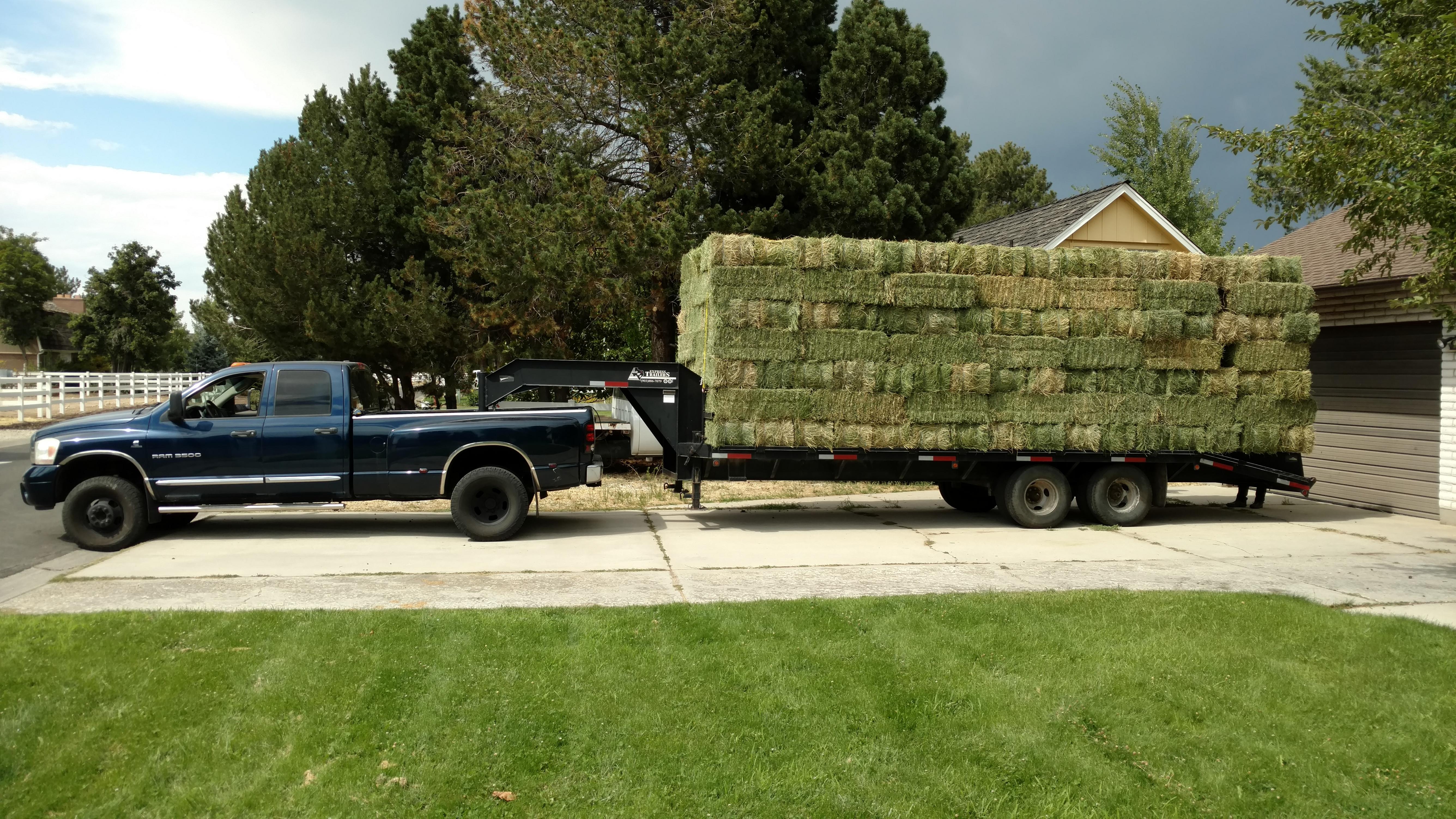

I switched out the G56 fluid about 1 year ago to the Delvac 50w syn. add the additional Trans Cool plate at the same time and all has been good alittle stiff in the shifting category on below zero mornings. Also last month pulled Solder Summit 3 times going from Price Utah back to Sandy with 10 tons of square bales Had to grab 3rd gear to keep the EGT's where they needed to be but she has been a champ.
