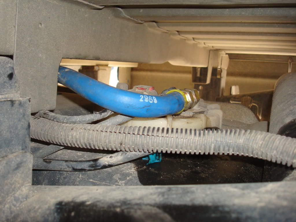

I'm looking at my filter assembly and I can see the round cylinder attached to it on backside of the filter assy nearest the firewall side. Does the Raptor 100 mounting plate attach to the same location as the OEM lift pump? From topside it looks like a tight spot to get wrenches into to r/r the lift pump with all the power brake plumbing and brake fluid reservoir in the way. Is it easier to remove the complete filter assy with lift pump attached and then replace pump? Hope it is as easy as you say it should be.
In the meantime, if you do have any pictures I could definetly benefit from seeing any install process shots you or others might have. I looked in your online gallery and didn't see anything that looked like a lift pump job. Any idea if Raptor has a installation PDF I can preview? I didn't notice any at DTR store site.

Yes. The raptor has a bracket that the fuel line hooks into that replaces the OEM pump.
The best way to get to it... put the driver side on a jack stand, remove the front tire and wheel well, then it's easy as pie.

I can't find the pic's of the canister, but like I said, if you pull the front wheel well, you will have plenty of room... even more if you pull the front tire. There are two bolts you need to take out for the stock pump... everything else is self explainitory with the directions AD has. Just make sure you tell Lary or whoever you order from that you have a canister mounted fuel pump so you get the right harness...

Excellent! I didn't think about the front wheel well approach. I went out and looked at it and yep it looks pretty easy to get at that way. I had hoped my new six ton jack stands and floor jack were gonna come in handy some day
Thanks for the pic's looks like a nice install.
