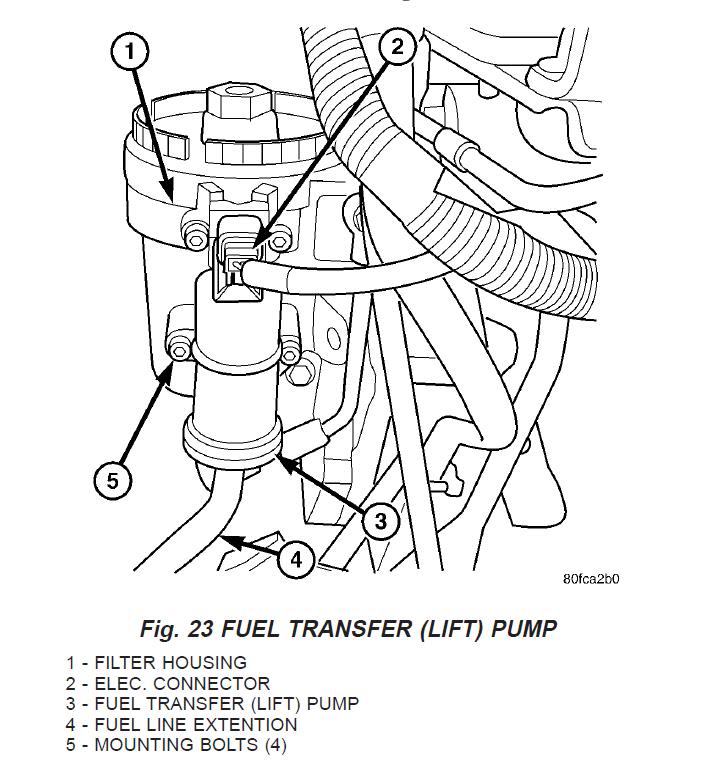

Went out and drained the filter housing using the petcock. Got about a cup out. Put the key in and turned far enough so it showed grid heaters symbol. No fuel pump sound. Start engine and it starts and runs only about 15 seconds. I've never been so glad to hear an engine die! At least its a straight forward problem now, not an intermittant one
Perhaps what happend yesterday was truck sat out in sun and fuel in the tank warmed up, perhaps enough to cause expansion of fuel in tank/fuel lines and up into the filter housing and that was enough to get it started and running for a while.
Found my warranty booklet and I am within 7/70 Powertrain and Cummins Engine 7/100 warranty (both with $100 deductable after 36k miles) and they cover towing to dealership if a covered part failed. However, no specific mention of lift pump covered under either warranty. It DOES state that it covers the fuel injection pump (CP3), water pump, etc. Since the filter housing and lift pump are bolted to engine block on my 04.5 (not in tank) one would think one of these warranties should apply. I seem to recall a few years back that there was another 04.5 member here that said his lift pump was covered by the engine warranty. Might have been a Dealer discretion call though. I will call my local dealership Monday to see what they say.
If I do end up doing the repair the part about having to lower my tank (178 lbs fuel plus tank weight) due to short bed clearances to attach a new fuel line is a bit perplexing. Although, I might be able to rig up a transfer pump to pump out all the fuel by running a hose down the filler neck. The other thought would be to use my floor jack with a long 2x10 board under tank to lower the tank/fuel just enough to get hand in to reach fuel line fitting.
At least now I'm back to a hard failure situation, nothing itermittant. I'm leaning towards going with a better pump solution (more reliable mfg. vs having dealer put in same failed part design if that is what they do). The thought of risking another dead on road failure in heavy traffic while towing my gooseneck loaded with 3 horses is not something I want to face even if I had a spare pump on board.

However, I went out just now and I can get a hand in there (barely) by laying on my back in front of rear tire and reaching up and over frame rail to touch the lines and connector - blindly though.

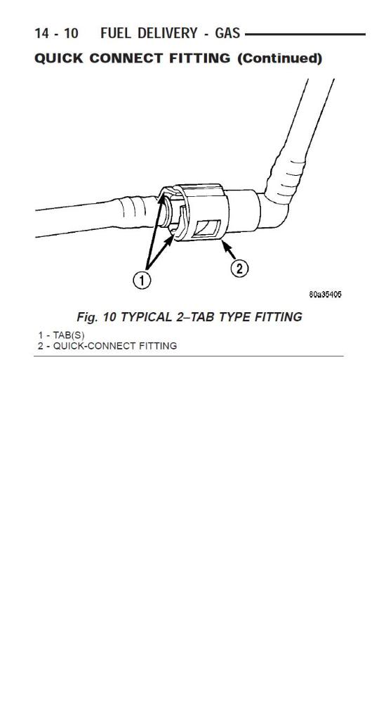

What has to happen to get a fuel line off? If I can get the right one off that way how hard is it to put the new fitting for the new Raptor fuel line. Maybe I can be a contortionist just long enought to attach it if it does not take a lot of pressure to get new fitting/hose on.
Unfortunately for me, the wheel well route is a no go, I have rear wheel wheel liners installed and GN hitch plate bolted to frame is blocking off access there anyway.
Excellent Madhat! Exactly what I needed to see. I'm thinking I can do this blindly by feel after getting my orientation with a quick mirror peek first. All I have to do is remove the rightmost fuel supply line and attach the new Raptor Quick Connect fitting. No messing with tank or bed removal assuming I have enough reach & room to work my fingers enough to detach & reattach a new fitting.
Yeah, you should be able to do it. My truck is high enough that I can almost sit up on the passenger side underneath and get to the tank, too... just gotta fight around the exhaust and drive shaft...
