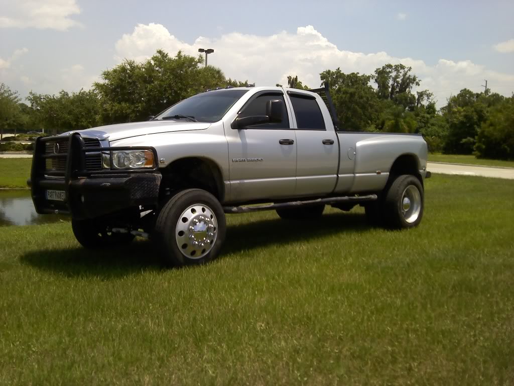

well thats what im afraid of, was kinda hoping more of a injection pump, cheaper then a set of injectors, i just spent my money on a set of custom cut alcoas and dont have the money for injectors now until i can sell my old standard alcoa conversion. anybody want some semi wheels with adapters and everything for dodge or chevy? lol $3000
