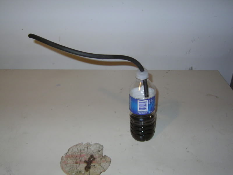

I have bleed dozen of systems, and many of them have had this pin. Not once have I ever messed with it. Most of the time when I bled my brakes I do it by myself with my state of the art brake bleed system....
I usually don't bench bleed my MC either....just lots of fluid and time to let things gravity bleed. When you leave things open to gravity bleed the air will move up the system and into the MC. Been working like this for years with no problems.

Any certain specs on that bottle? Does the cap fit tight around the hose? Can you just crack the bleeder then pump away on the pedal?
I bench bled my MC until there were no air bubbles. Now I have it hooked up to the truck and am letting it gravity bleed 1 wheel at a time starting with the right rear. I put a piece of clear vinyl hose on the bleeder that drains into a jar. I made the said hose go up higher then the wheel cylinder/caliper then down to the jar.

The bottle is just a regular water bottle form the store. I punched a hole in the cap and fed the scrap piece of vacuum hose down and into it. I also punched a small hole in the top of the bottle near the cap as a breather. I usually just crack the bleeder screw, then hook up the hose and let it sit on the ground. Then I pump the pedal about 6-10 times, then check the MC for fluid level, then pump a few more times. After the pumping I let it gravity bleed for 10-15 minutes then close it up and move on to the next wheel.
Like I said I've been doing it like this, by myslef, for many years now and have never had a problem.
