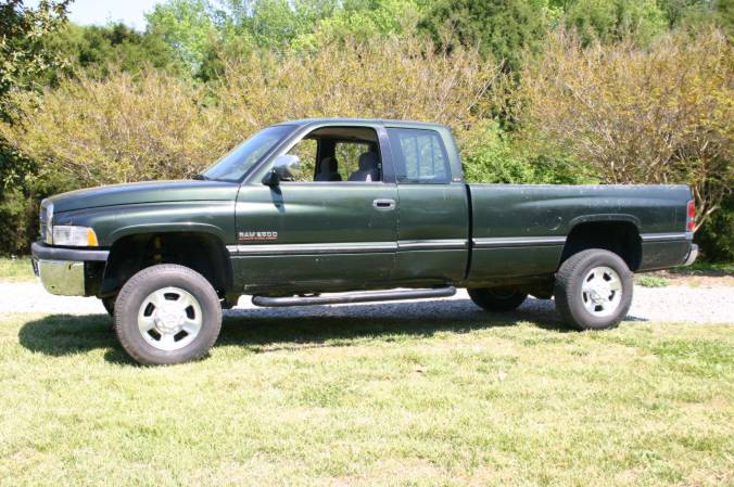

Mine are 16" wheels, and the previous were 16" wheels. The difference between the 96 and 99 may be a factor. I put the 2000 16" aluminum wheels on my 99, and had to grind the front. My 96 has 2004, 17" wheels on it. No clearance problem there.
In 2000, Dodge changed the front diff, in addition to putting smaller drums on the rear. They relocated the end of the steering knuckle to be more centered in the wheel radius, and flipped the ball joints so they connect to the axle housing from the opposite direction. This allowed the 2000+ wheels to have a smaller inside diameter and clear just fine.
They went to 17" wheels in 2003, as they changed to different brakes and a different axle manufacturer.
Chris

The 96, with the 2004 17" wheels on it.
