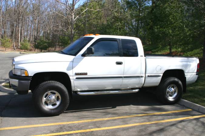

Interesting. What kind of aluminum rims? Trying to verify the style.
Which direction do your ball joints go into the axle from?
These are the 2000+ wheels I am talking about:
I wonder about this because even a mid-year change would have to be a 1-99 manufacture date.
Thanks,
Chris

That looks like the rims, been a while since I paid any attention to them. They weren't on long. If the updated rims were a big difference in looks than I am sure that is them.
