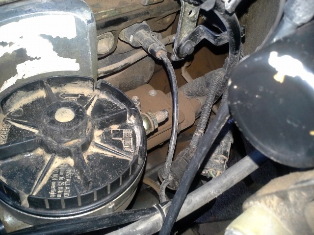

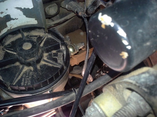

I removed the power puck 7154 from truck. I checked the plug for the fuel pump in tank and it's getting power. I pulled the hose from the lift pump to the Fuel Pressure Test Port(Inlet) and bumped the key to activate the 25 second run. There is no fuel getting to the test port. None, dry as a bone.
Either that lift pump is bad, plugged, or I got an air leak somewhere in the line. I replaced the pump in the tank so I know it's good. I was told I shouldn't have both lift pump and electronic pump in tank. I am attaching two pics of the lift pump that I have. Does this one look like the stock cummins lift pump? Excuse the dirt. Truck was in oil field.

From the pics I can't tell if that is a dealer installed block off plate or the stock lp.
If you have a spot air can get in, fuel should get out when the pump is running. I would trace the fuel line from the top of the tank to the area below your filter housing there to ensure it is good.
An outside mounted lp cannot draw fuel thru the in tank lp. If yours has both, then the in tanker was supplying the block mounted lp which sent it along to the filter and vp....
