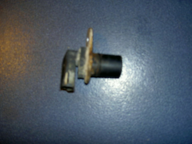

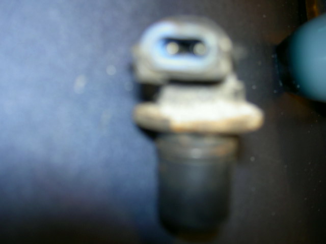

I went to 2 parts stores in town, they showed in their books, 2 differant styles then mine. One of there's had a harness to it, and both had 3 prongs, mine has a 2 prong setup. Is this like your setup? thanks

well I put a new sensor in this morning, still no speedometer. Any other ideas? Thanks

Do you have ABS lights? Yours is likely the ABS sensor in the rear. On his truck, the speedo is picked up in the tailshaft of the t-case (or tranny, if it were a 2wd), so the rear end sensor has no affect. Yours will either be a bad sensor, or a broken wire.
