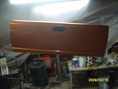

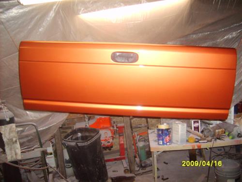

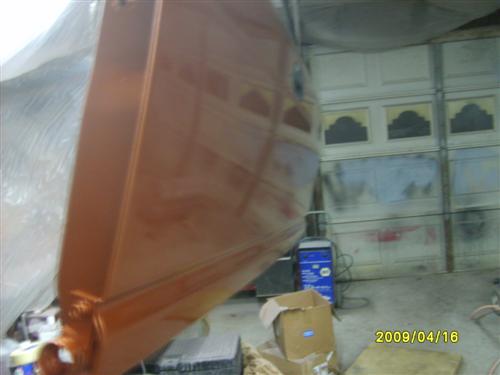

Tailgate is done finally. I haven't had much time lately, but I sprayed it tonight. I'm gonna install it tomorrow, then pull the truck in & start working on getting the rockers ready to spray. **** Line-x guy....I would be done right now.

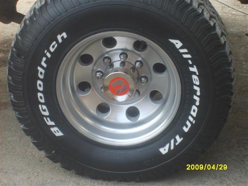

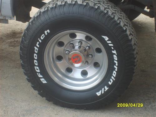

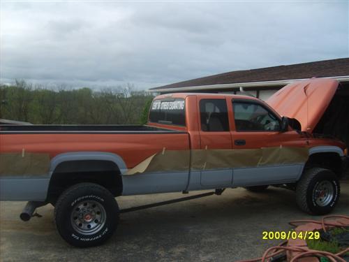

I got all of the bottom [rockers] of the truck ready for paint....amazing what you let go when you think Line-x guy is gonna deal with it. I plan on shooting the rockers the next day off work. Yesterday I sanded/polished my wheels, don't look too bad considering the way they looked before. My rear bumper showed up today [brand new replacement]. After work today, I cleaned out the shop & I am ready to spray. Almost there!!!

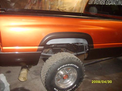

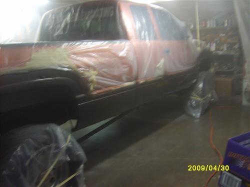

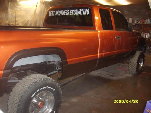

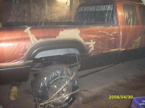

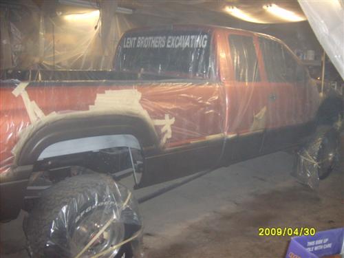

I just walked in the house, got tired of waiting for a day off. The rockers are done!!!! I'm going out to unmask them soon, I'll get better pics.

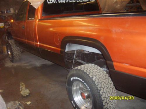

Just unmasked my beast

how did you fix your wheels? i have the exact same ones.
My wheels were neglected for a long time, had to sand them with 220 wet, then 400 wet. I used a red scotchbrite pad to get in the small areas, then polished with my buffer using mothers metal polish & tight ares with a powerball.
