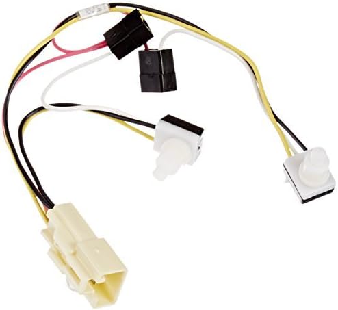

Switches from amazon
The switches are available from Amazon and are much like the stock ram stuff, , as is the entire wiring harness, prices are all over the place depending who it is from, I should add that there are two types of wiring harness, the one pictured is with out the digital readout, (temp, fuel, engine time etc), the harness for for overhead including the digital readout has an additional thin flat connector for the readout.
