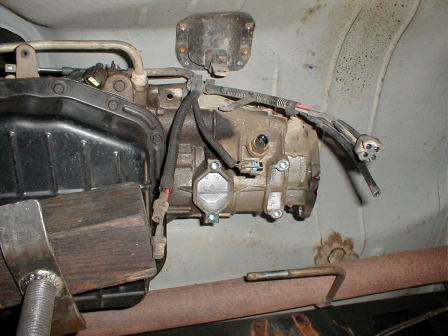

There is a speed sensor on the tranny tail shaft. It has something to do with the speed reading, but it is not clear to me what it does. I have heard that it merely tells the rear speed sensor to heed the signal it is receiving, and I have heard that it works up to 20 mph, then the rear speed sensor takes over. Either way, that is probably your problem.
Chris

See it on the tail shaft? It is unplugged, and the plug is hanging just below it.
Chris

Stamey, that's exactly what I replaced.
Interesting view you have there, remembers mine, same view 2 days ago.....
