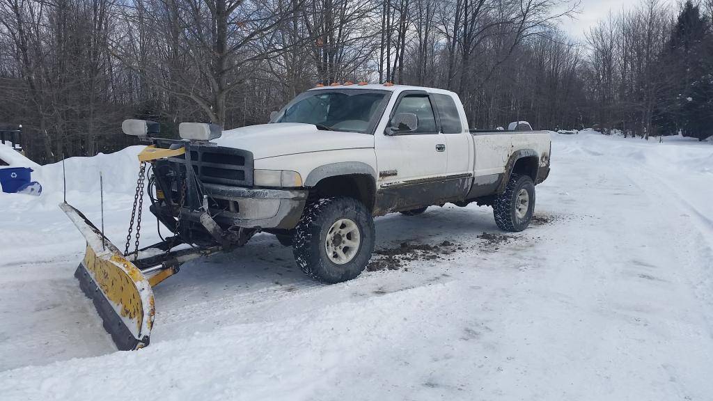

well got my new piggy today
finally found something I like..
-Al stock........... for now
