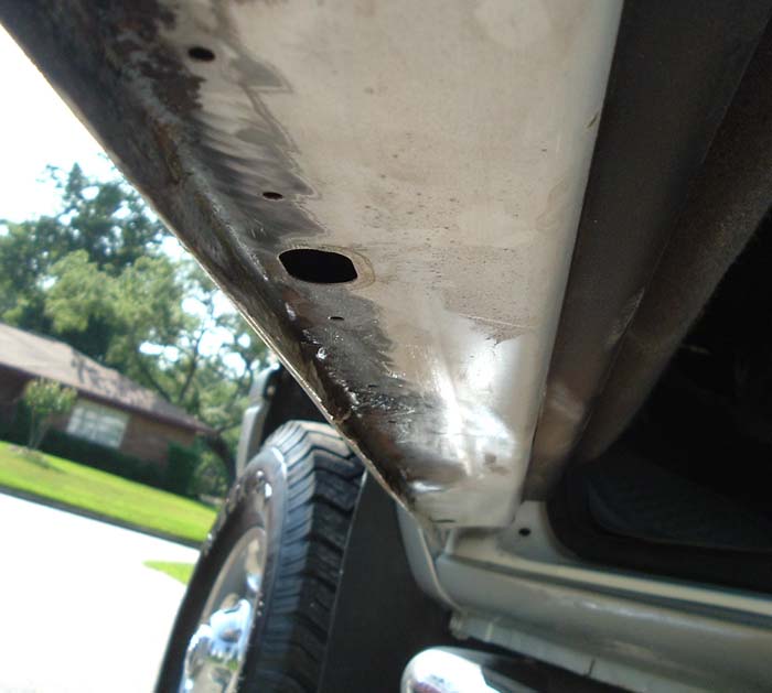

When I bought this truck I knew it had a few issues, being a WV truck. Now it's in Texas, and I'm planning on fixing all the issues the right way and never have to worry about rust again. The worst place was, of course, at the door seam on the bottom of the drivers door. This was the only place on the truck that needs new steel. Anyways the pics are below.

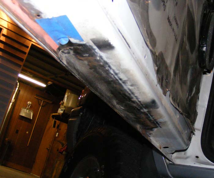

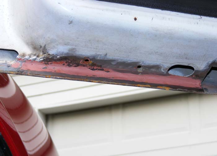

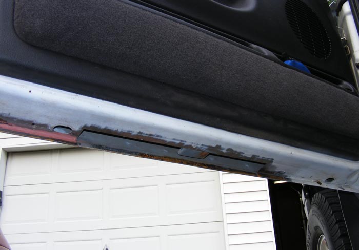

These first three are the damage after I knocked the paint/rust down. It's pretty rough. The part of the outside panel that folds over the inner panel is gone or severely corroded for a good portion of its span. Also the inner panel section has corrosion a good ways up.

Next, I chopped out all areas with corrosion or that were missing all together, until I got some steel I could work with. Lucky for me all of this is taking place on the bottom of the door, so I won't have to paint match anything to an outside surface
Also, you can see the quick fix I did on the outer door skin lip on the last pic. BTW the bondo there is only about 1/16" thick, very thin skim coat, otherwise I wouldn't be going to all this trouble!

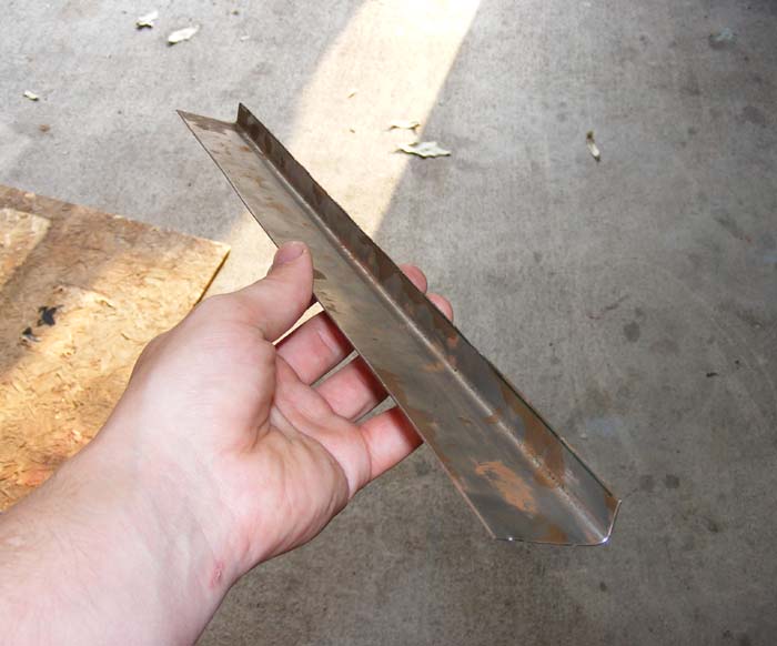

Next I made up a small patch from 20 ga. steel, I bent it over my workbench and eased it into shape with a hammer and dolly.

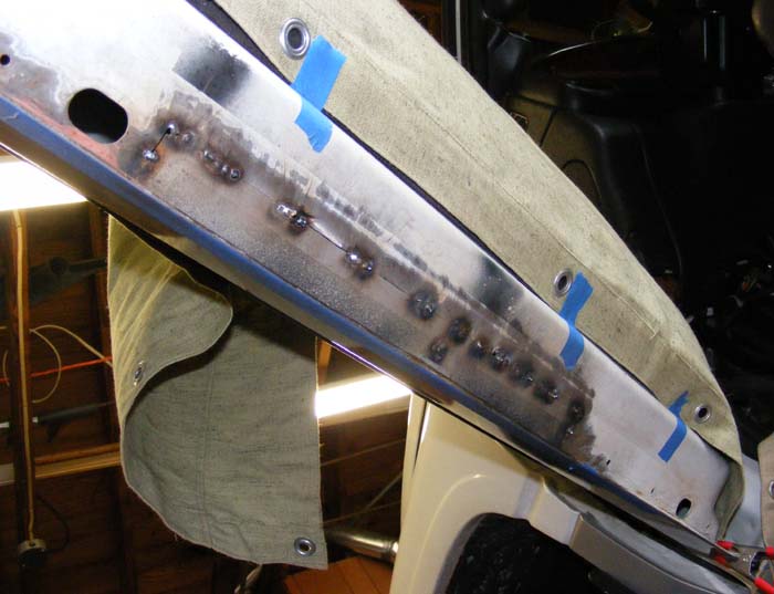

Then it was tacked in, fully welded, and ground flush. Now after this it was very warped on the bottom from the heat. No worries, get out the hammer and dolly and planish the metal back into shape. Took a good hour of hammer work but now can run a ruler across the bottom and not see any gaps the whole way. Besides with the door panel off It was a great time to replace the speakers, plus ill coat the inside with some oil to prevent rust before the panel goes on.

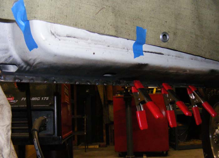

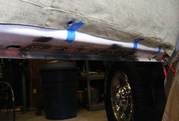

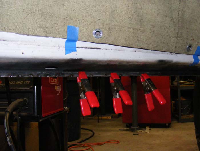

And now to where I'm at now. All the steel left needed to weld in is a LONG strip to replace the outer door skin lip that fold around the inner skin on the bottom. This was a little tricky because I didn't want to lift the paint on the outside of the door from the heat. This way when i paint the only place you'll be able to see it is when you open the door, and itll be no more than a line where it goes from new paint to old paint. To do this I held a wet rag on the outside of the door directly behind where I was welding, and took my good ol time with the welds. No paint lifted, so looks like I'm good to go.
All that's left is a few more passes of welds, grind them down, dolly work, skim coat of bondo, and paint.
I'll get more pics up when the results are in.

Sure, I've got a Lincoln Pro-MIG 175, set at voltage tap "B" and wire feed to ~3, which equates to 21.5VDC and ~150 IPM.
