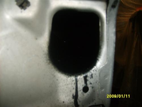

Today I installed a new LH front fender on my truck [very fun]. I sanded down the inner fender & coated it with roll on bedliner before installing it. I wanted to coat the backside of the fender to prevent future rust & I found access. I sprayed a entire can of spray on bedliner through a access hole behind the parking light & was able to shoot throughout the entire panel through that hole. If I locate my camera, I'll get pics before I put this thing back together.

Here are pics of the hole & inside the fender.

yeah the turn signals give good access to the fenders front and back. I sprayed mined down with rust converter and zinc paint.
