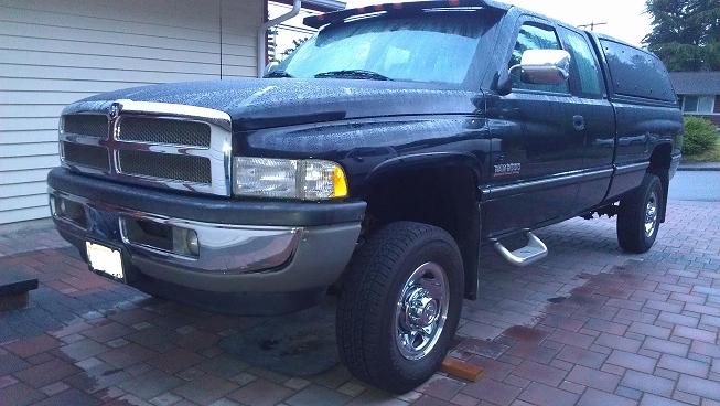

No problem. Here is a photo of the truck with the stock 96 power mirror type I am wondering about. Just don't want to snap something if they are not meant to fold flat against the doors LOL!
