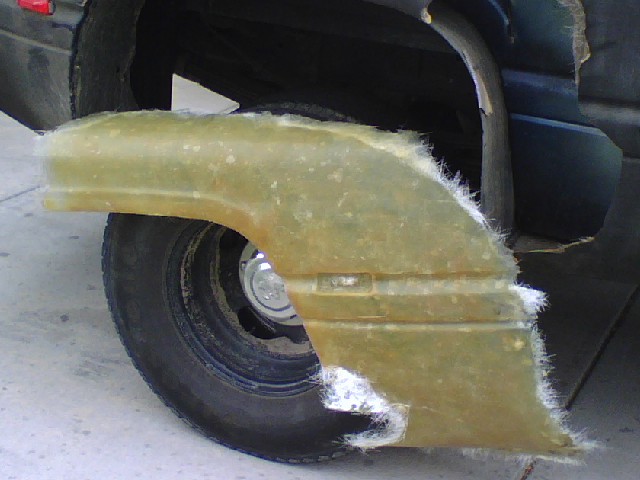

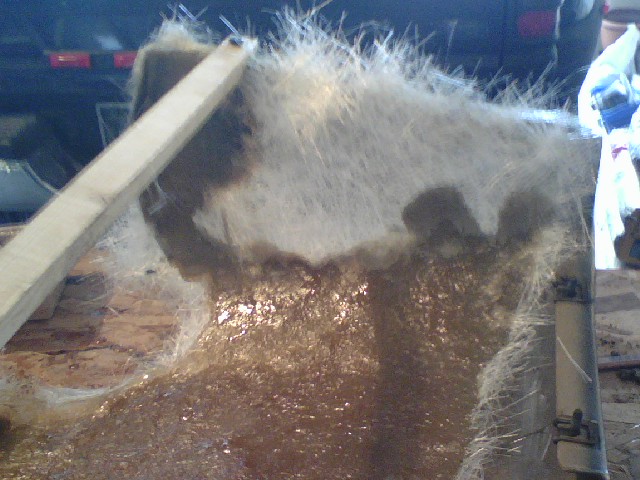

Well the time has come to repair my dually fender. I have a hole that seems to be growing day by day. It's now large enough to store a small dog inside the fender and thats too big for my likeing .
The hole has taken out the resess for the marker light, the two "valleys" all the way from the botton to the ridge at the top of the fender where it begins to flatten out.
I wanted some sort of mold to base my repair on but i didnt want to form it out of plastic or foam or anything so i uset the drivers side front section on the fender (inside) to make a simple mold to fit on the inside of the passenger side rear section to form up the repair with all the correct lines.
It worked pretty well seeing that the two ARE a little different in size. Exerything else is pretty proportional.
As you can tell the drivers size ALSO has a small hole i need to repair too but at least i get the majority of the hard lines to base the repair off of.
What do you guys think?! Any sudgestions?

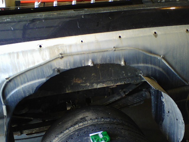

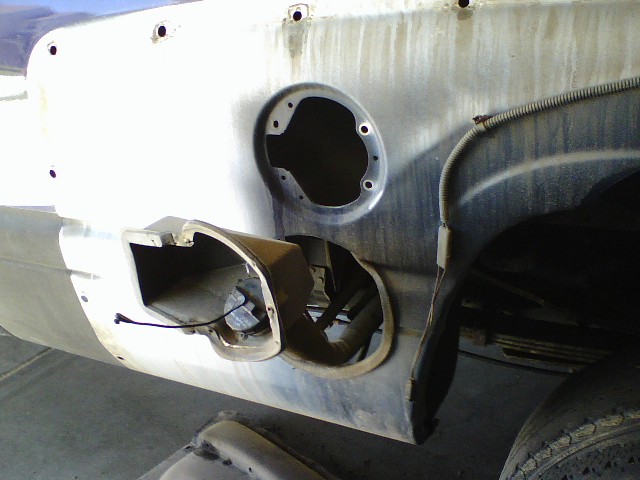

Now keep in mind this is only a mold! This is atteched in the inside for a base. I will add about four or five layers to the outside tieing it all together and feathering the fiberglass over the origional fender. For all you guys asking about converting a dually to a SRW truck i have also taken a couple photos showing what the DRIVERS side looks like with the fender removed. As you can see you would have to do extencive body work to get the dually bed to look right with Single rear wheels. Hope this helps a bit.

Ill tell ya what man, you better get some backer behind the cracks to support them a bit more. i had just a small hole with a few cracks to start with and every time something hit it the hole got bigger and bigger. i work construction so the trucks takes a beating anyways.
the wole started about the size of a socker ball and once i hit strong head winds on the highway it blew the rest of what you see out. Once these fenders get cracks they lose alot of their structure. and become pretty weak. it's better to reinforce em now when you still have the pieces to keep it together then to try to reform a new piece.
