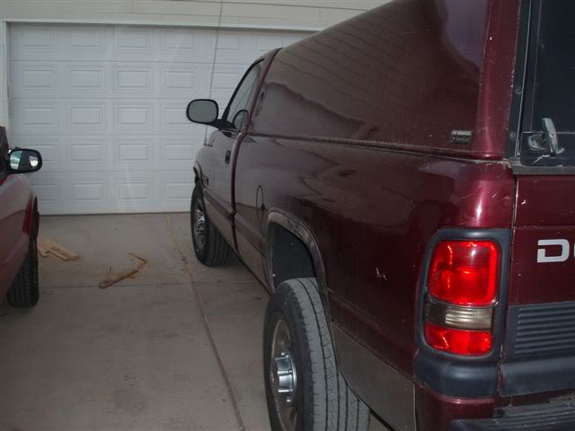

i used 2500 wheels an a bed from a '95 2500

So 1 unaswered question I had was I see these photos of there being the factory fuel door there on the factory fender is that the case?
Old Aug 25, 2016 | 02:05 PM
johnh's Avatar
Joined: Nov 2002
Posts: 4,053
Likes: 29
From: lyman, utah
as far as i know the fuel door is the same on all the beds dually or single
