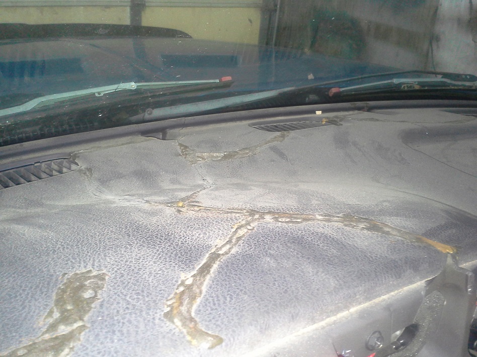

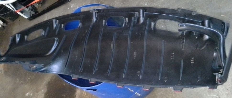

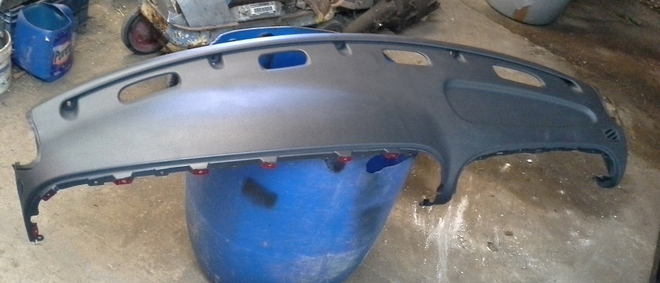

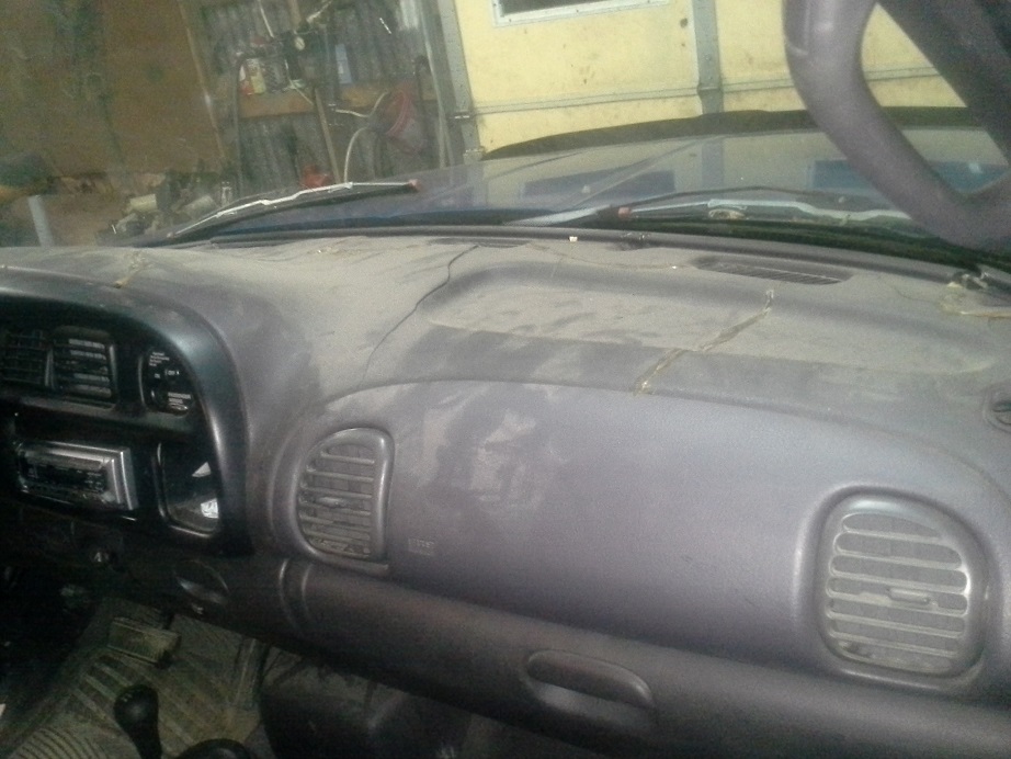

Just wanted to share a couple pictures of the dash in my 2000 Ram. I took some before, during & after.
This one was repaired at some point & was just starting to get bad. Then I noticed after replacing my cup holder that I had to push the trim bezel up to open it...which means it's starting to flex underneath
So I ripped off ALL the plastic; dash & underneath/bottom.
I had a dash laying around that was good but the wrong color (of course) so I sprayed it with colorbond...which works well...even with no promotor/cleaner.
Also, on the underside of the dash, I used a can of that Flex-seal that fixes leaky gutters, etc. I wanted to make some kind of a membrane just in case this thing decided to crack again; it might not fall in on itself.
& I went with my junkyard find woodgrain dash trim, & cup holder...& my old CD player that's probably as old as the truck & has been in about 8 different vehicles I've owned ... sorry the pics aren't the greatest.
