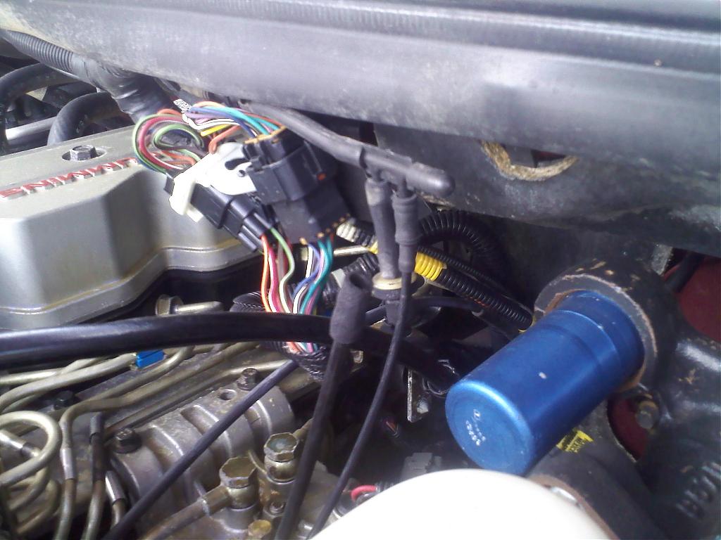

Hey guys,
Well I will start by saying I am not very knowledgable when it comes to vehicles but I am always trying to learn. I just returned home from vacation and on the drive back the cruise control didn't work, and at the same time the a/c only came out of the the defroster vents and down at the floor and not around the instrument panel. I took a look under the hood and noticed a problem with what I think you would call a vaccuum line (told you i am not very knowledgable. I posted a pic of the broken line and was wondering if that would cause both my cruise control and a/c problem. If so, do you know what I should replace?
Thanks a lot for your help,
Brandt

Yes, that would cause BOTH problems, it looks like it's just unplugged?

Yep. plug it back in and enjoy.
Happens all the time.

I do not think I can plug it back in, I believe the rubber sleeve that holds the plastic tubing together broke so i cant push it back in.
Ive replaced some of mine with regular vaccum hose.

K, just pull the pieces and get some at any auto parts store. You will probably have to buy a foot unless they feel sorry for you and give you a little bit.

What they said. Good time to go over all of the lines and replace as necessary.
