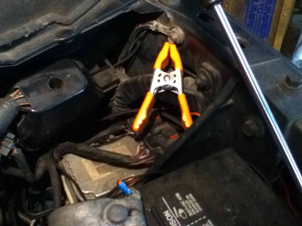

Your symptoms lead me to believe you have a loose or corroded ground wire.

Spent some time poking around under the hood pushing/pulling on things and lucky enough, happened to tug on a wire cluster which led back to a slightly loose and corroded ground screw! Uploaded a photo for better reference... its the ground screw touching the tip of the orange clamp (located on driver side fender rail).

According to my factory service manual my '95s have 16 wires attached to a chassis or engine ground.
They're all over the place.
If you have a low amp short to ground that's not enough to blow a fuse and is usually caused by faulty aftermarket wiring or an accident it can cause electrolysis that corrodes your ground connections.
