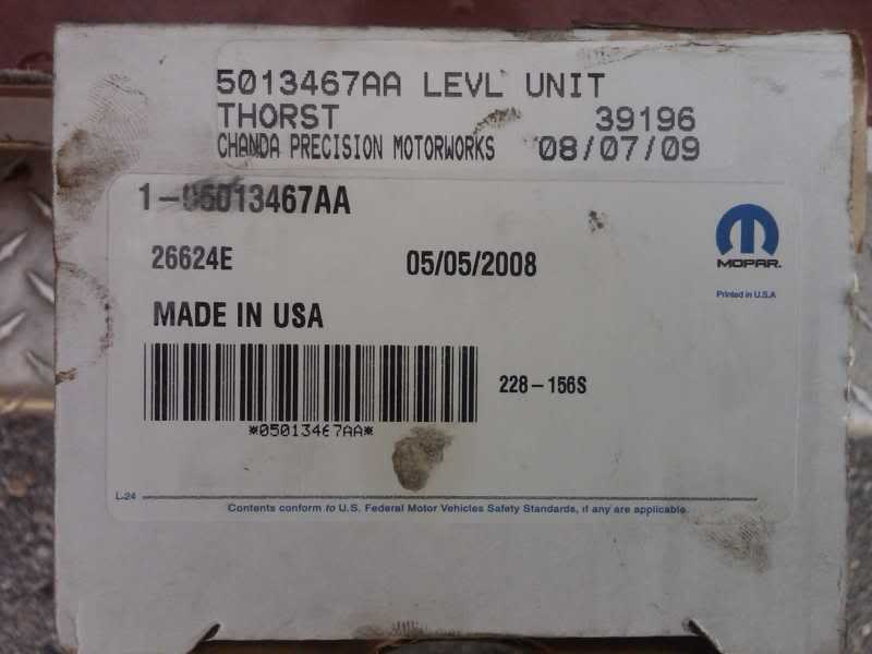

Old Jan 22, 2010 | 12:54 AM
1-5-3-6-2-4's Avatar
Posts: 3,142
From: Okotoks AB
that there is what you want. I just put that one in a '97 recently. it is a dealer only part. at least around here anyways. its not that expensive anyhow.

Old Jan 22, 2010 | 09:09 AM
b1mmuo27's Avatar
Joined: Jan 2010
Posts: 84
From: Waterford, Ontario
Thanks looks like the one I took out of a 94 Dodge van.
