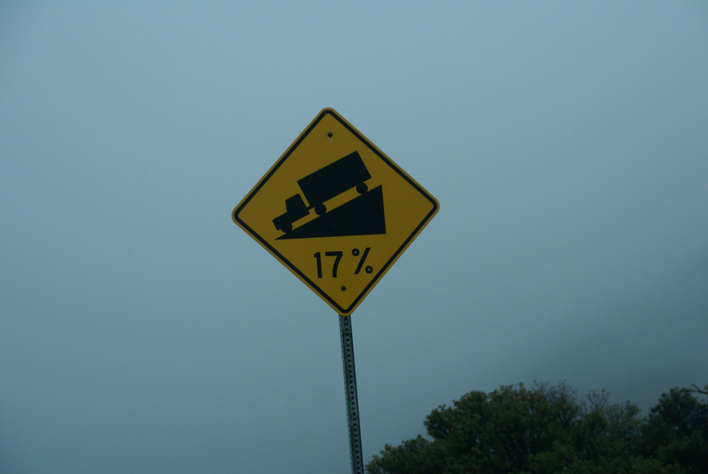

Uneven lug torque, or holding the brakes hard at a stop while rotors are red also can warp the best of them. This is the sign as we start down the 8 mile hill from our hunting unit- Elevetion at the top is over 10,000 feet and only 900 feet at the bottom! I hauled a 20k Hitachi EX90 up and down this several times this summer as we dug watering holes for wild game. Cycleing betwen trailer brakes and truck brakes and locked down in 1st and sometimes even useing 4lo 2nd gear is the only way to keep the brakes from failing. They are still glowing red and able to light a cig off em when we reach the bottom every time! We carry a air wrench, welding gloves, jack and CO2 extinguisher just in case the trailer brakes set fire to the hubs! The EBC rotors still have not warped yet

Is this in OR? I've never seen a 17% grade sign anywhere I have been in OR which is certainly not everywhere.

This one is on California State Route 4

Holy cow, I couldnt imagen 24%! 2wd trucks pulling any load would need a locker on wet pavement. I have to use 4wd on wet 17% sections if I have any less than 500lb toung weight
