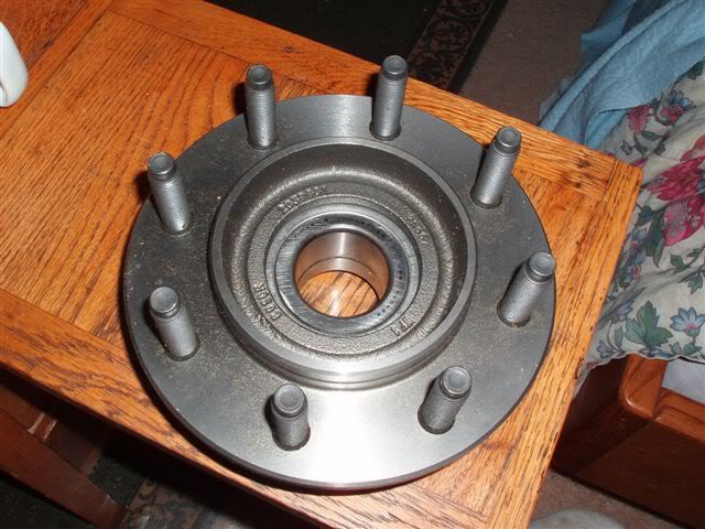

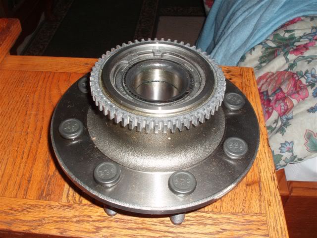

if the 02 is the same as my 01 the axle nut is not reusable, it's a self locking nut....... also the front wheel bearings are not serviceableName:  P1010164.jpg

Originally Posted by Wilbur01
Mine is a 2wd drive truck , are they the same?
the pictures are for an 01 2wd. i would think the 02 would be the same.......... call the parts store
