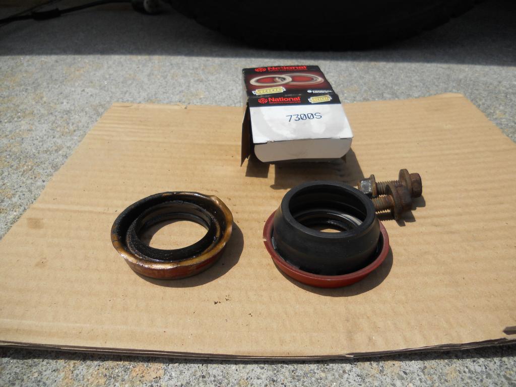

I switched it out today.
I don't know if the tranny place used a cheap one or the design was changed but my part looked different than the new one. The new one looks improved, there is a second seal to keep out water and stop rust from making the yoke rough and eating the seal (what happened to mine)
The old one is on the left and the new part # is National /Moog 7300S

Yep, first one is a cheesy trans rebuild seal, the one you put on is like OEM.
