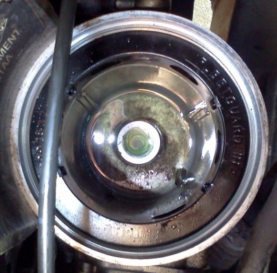

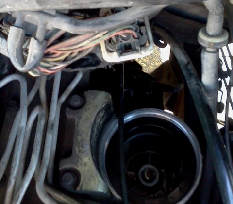

I was just out looking things over and checked the filter and it looked like the filter/water separator didn't fill back up after I put in the new filter.
I took several pics a few minutes ago and am going to post them within 30 minutes.

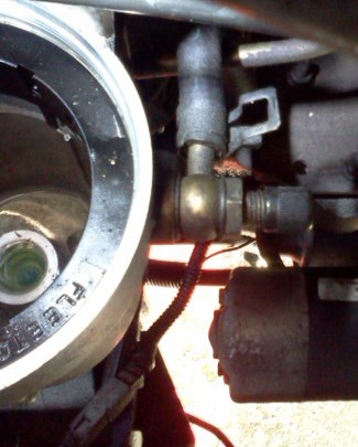

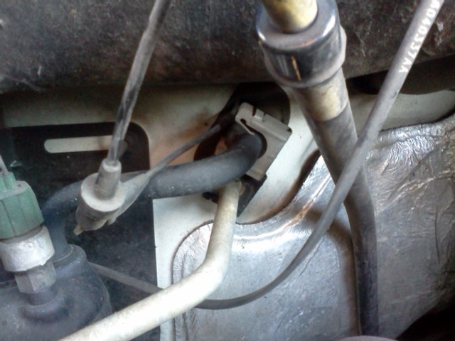

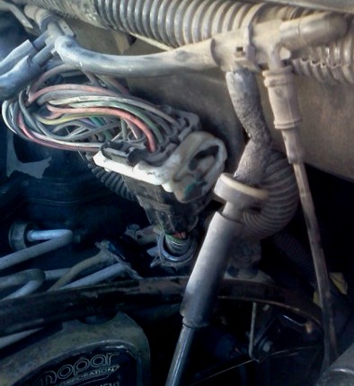

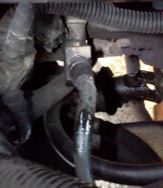

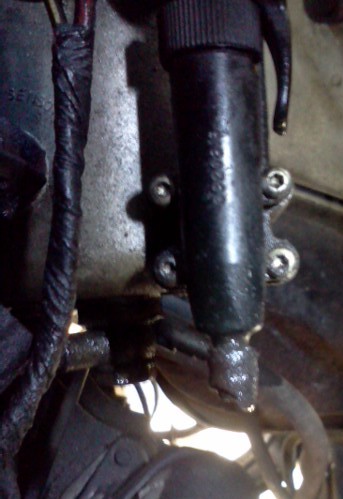

Here are some pics I took and I found something that certainly doesn't look right but, I am not sure what I am looking at exactly.
The rubber in the first pic is in bad shape and it is connected to what is in the 2nd pic.
posting 2 more now

Hopefully one of the more experienced folks than me will chime in soon. That black rubber line looks like one of the vaccuum hoses to me.
To work on the easy stuff, get that fuse replaced. There aren't many fuses in these trucks that don't do anything. If it is the fuse for the LP, your filter housing should fill back up with fuel. The second fue box is in the engine compartment, on the driver side, between the battery and the firewall. It has a thumb screw on top to open it. Most of the power train fuses are in the box in the engine compartment. When I can get to the truck tomorrow, I will take a picture of the interior fuse panel door and post it here for you for future reference. It has all fuse locations labelled.
I agree the rubber line is a vac line. to the left it goes to the defrost controls and I think down to the 4 wheel drive cad. I t needs to be replaced. Also agree replace fuse. Just pulled the cover off on mine the 10 amp. next to wiper is cluster B. Check the fuse at number 9 position it is for the engine and is the one I pull as a antitheft. When it is out engine will not fire. The one below the wiper is backup lights.
You must be right that it is a vacuum line. The rubber being broken down and further down the same line you can see the rubber is kinked. Not sure how bad something needs to be before it won't work.
