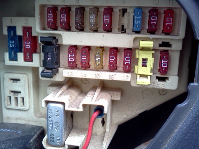

Interior Fuse Panel
Here you go
Attached Thumbnails Started fine, drove a few feet, sputter & wont start - '01 2500 5.9 Cummins-image.jpg

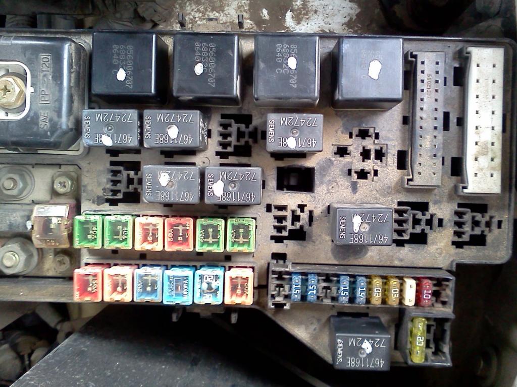

Here are my fuse boxes. I am going to buy new fuses today.
The one missing is for the radio.
Attached Thumbnails Started fine, drove a few feet, sputter & wont start - '01 2500 5.9 Cummins-img998.jpg   Started fine, drove a few feet, sputter & wont start - '01 2500 5.9 Cummins-img1000.jpg   Started fine, drove a few feet, sputter & wont start - '01 2500 5.9 Cummins-img1001-1.jpg
